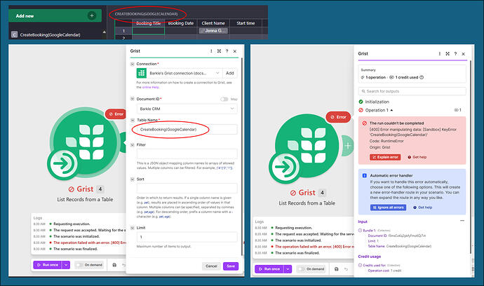

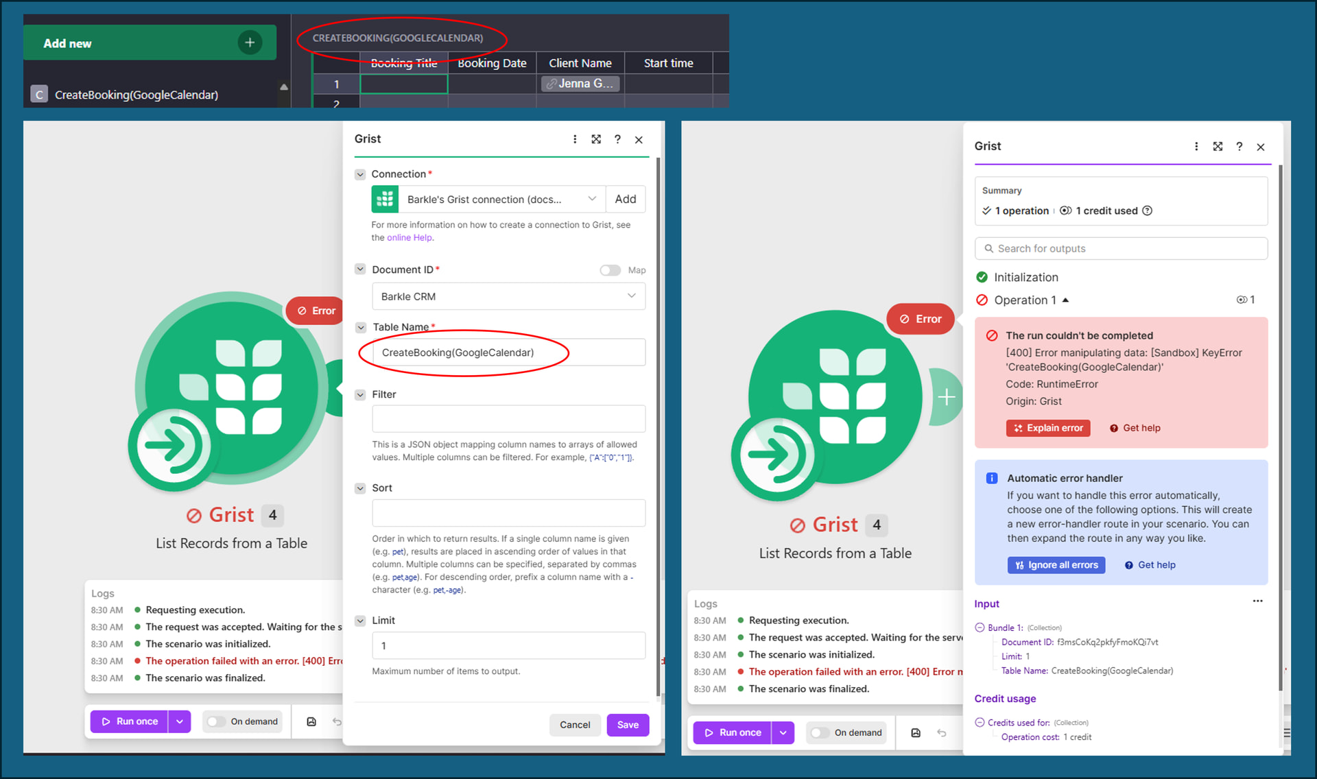

I’m trying to set up an automation where I sync data from a Grist table to other apps, but just can’tget make.com to access the table?
Below is my table name, which I’ve put into make.com, but it won’t work. What am I missing?

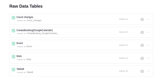

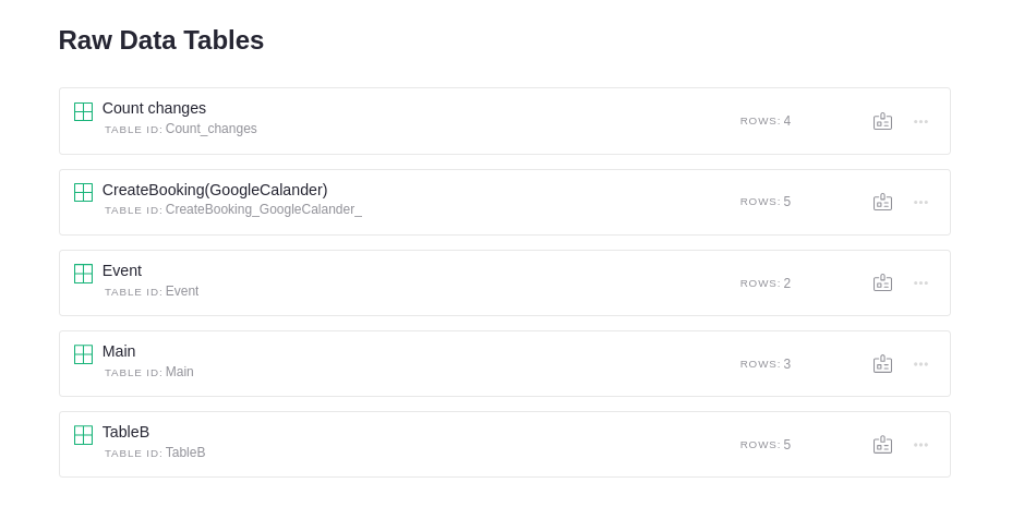

I’ve never worked with make.com myself but I suspect your problem is that the display table name and the table id are not the same. This happens when you have spaces or parenthesis or other non-alphanumeric characters in the name of your table. You can go under “raw data” (bottom left in grist) and you can see the table id names for your tables. I did a quick test and I think you should have something like as your name which should work in make.com
CreateBooking_GoogleCalendar_
Thank you so much! This was exactly what I needed.
I’d assumed it was something like that and had been looking for the table ID, literally checked “raw data” but apparently I can’t read, because it was right there! Thank you :slight_smile:
