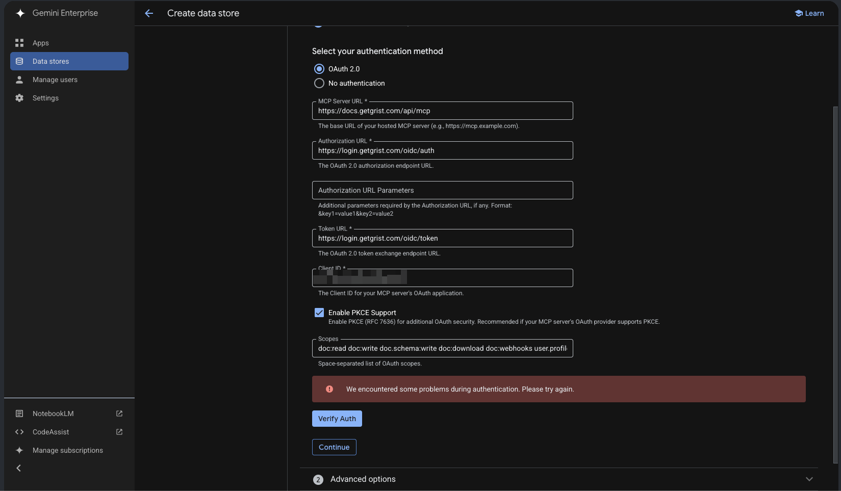

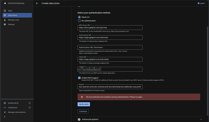

Gemini Enterprise requires to fill Authentication method by myself. The screen below shows how I did it.
j
The connection was created according to this google documentation:
https://docs.cloud.google.com/gemini/enterprise/docs/connectors/custom-mcp-server/set-up-custom-mcp-server

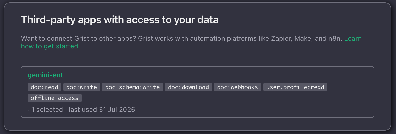

After clicking Verify Auth a Grist authentication window appeared, where I proceed to allow access.
Grist shows that third party app is authorized, however as you can seen in the google console screenshot there is a problem with authorization.

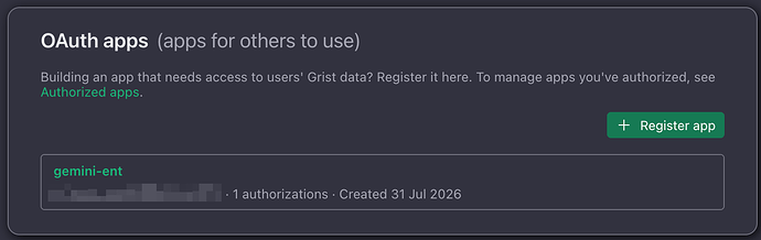

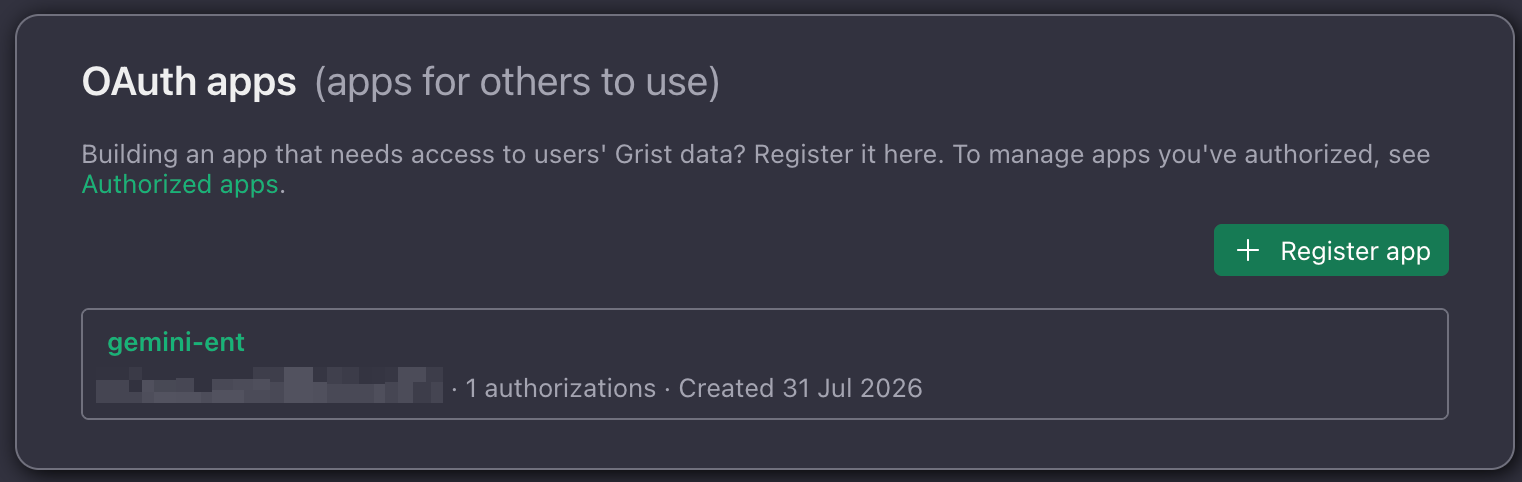

In order to auth third-party app I created an app in the Grist developer system. The scope and the client ID was checked multiple times.

The log in the google console page does not contain any request to vertexaisearch.cloud.google.com/oauth-redirect.
Moreover the error:
We encountered some problems during authentication. Please try again.
occurs before I complete the auth process in the pop out window.

Firstly, be sure your connector checks both “Enable PKCE Support” and “Use HTTP Basic Authentication”:
For scopes, be sure to include offline_access. To include all scopes, you can paste in this string: doc:read doc:write doc.schema:write doc:download doc:webhooks user.profile:read offline_access.
