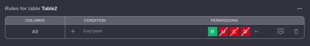

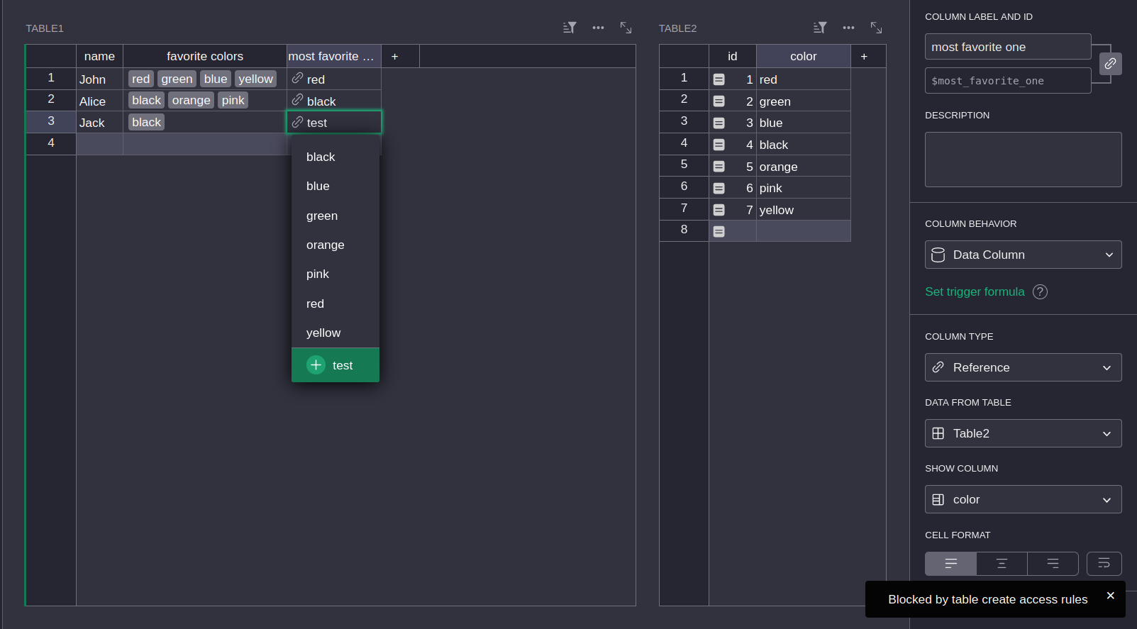

You could replace your Choice column by a Reference to a table that could be made read-only. Sample here.
