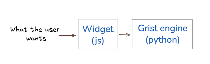

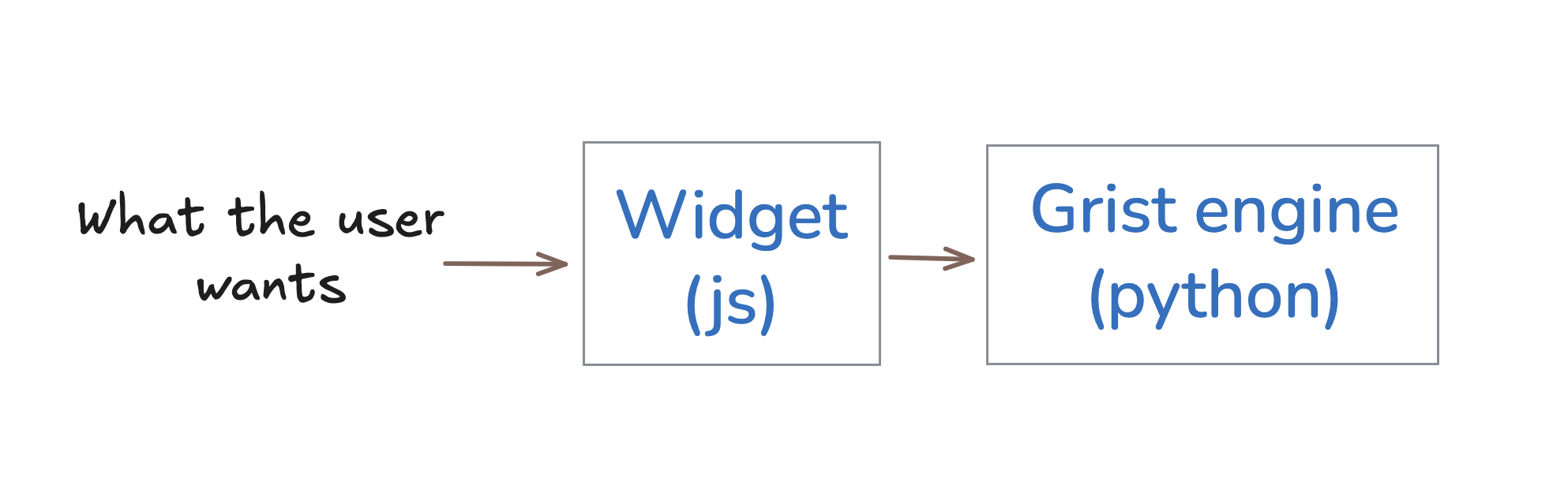

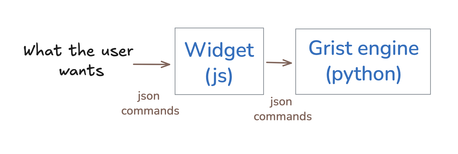

The solution is to Serialize the commands. This means the user can write commands, these commands get converted to text (json), are received by your widget, and are forwarded to the grist engine.
This brings another superpower: even if the core is in python and the widgets in js, you can communicate easily between the 2. You can even store them in a Grist table !
This is what userActions are: json commands you can pass between python and js.
