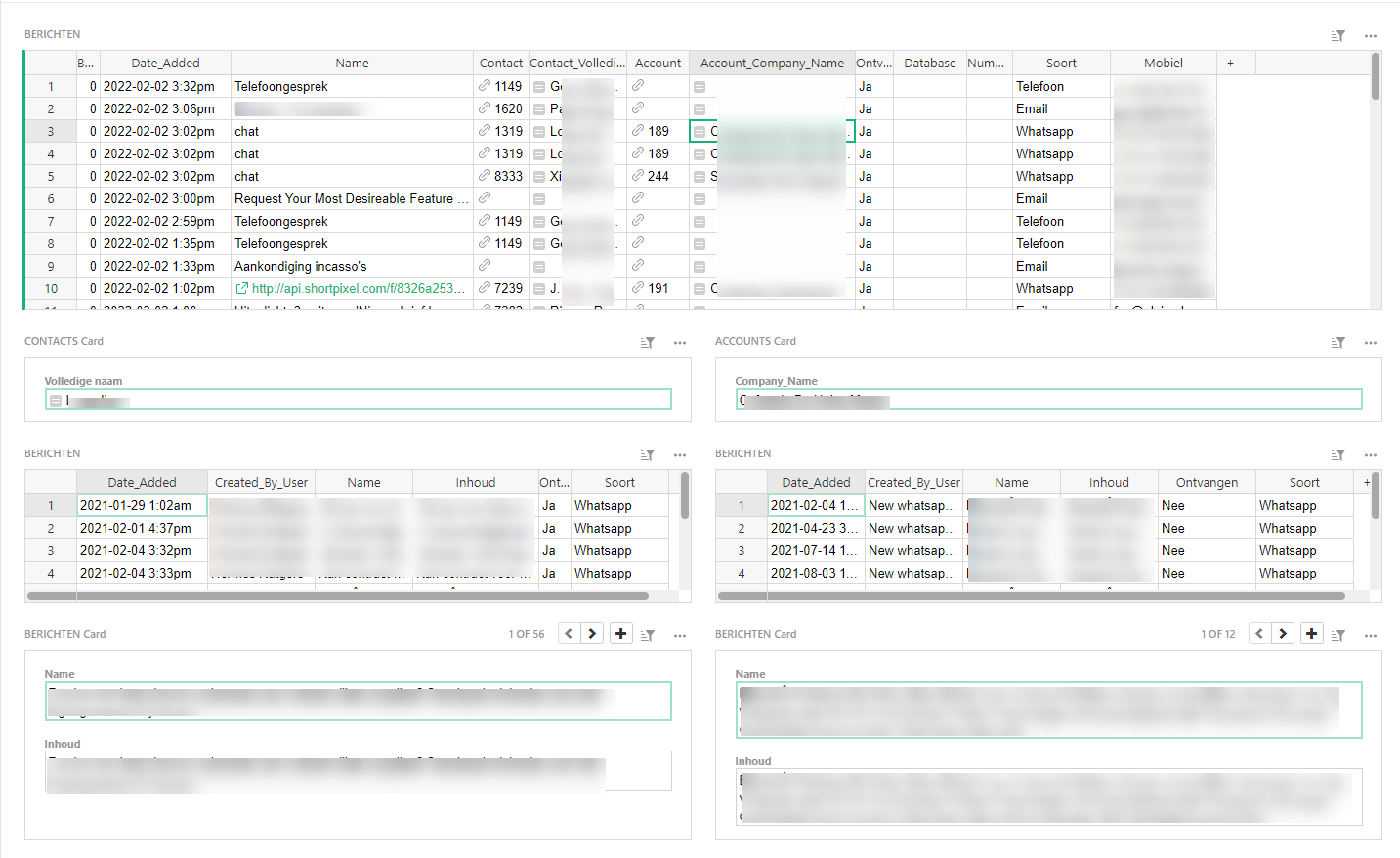

@dmitry-grist Is it possible or in theplanning that I can link a field inside this table to another Grist table. For instance, I have an accounts card with company name. I would like a link that opens the company entry in Grist.
Hi there!
I’m not 100% sure on exactly what you want so I’ve tried to cover all bases with the information below.
If you’re looking to have a card on the page you took a screenshot of, you can add a Card Widget. It looks like you might already have that set up though. I have added instructions below just in case. If you’re looking to have a hyperlink that would open the Accounts page to the correct company, you can do that using an anchor link. I have added instructions on how to do this below but there are two options. You can add the hyperlink column to the Berichten table or to the Accounts card. Instructions for both below - if adding to the Accounts card, be sure to read the instructions in italics.

WOW amazing, thank you very much for the detailed instructions. Just what I wanted.
Or I need a 80 inch screen so I can get all in just 1 screen:)
