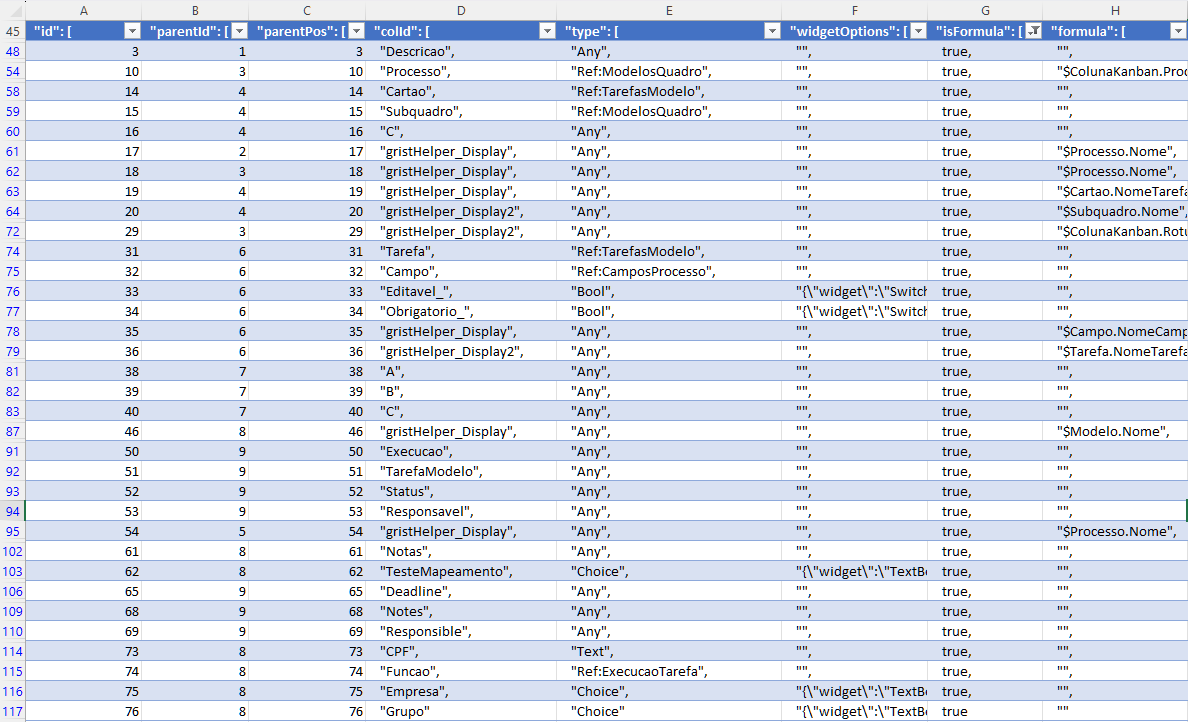

here, I mounted the data in an Excel table… look the amount of isFormula columns marked with “true”, while column “formula” shows no formula at all
I also noticed it but only for empty columns:
If you are developing a custom widget, when querying column metadata via grist.docApi.fetchTable(‘_grist_Tables_column’), an empty column without a formula will return
isFormula= true
and
formula = ""
This may be surprising.
Here is a table summarizing what the isFormula and formula keys return in different scenarios:
Column status isFormula formula
Empty column true ""
Data column false ""
Trigger formula false "a formula"
Formula true "a formula"
To distinguish between:
  • Classic data columns (editable by the user)
  • Formula columns (read-only, calculated)
two checks must be performed:
const isFormulaColumn = isFormula && formula?.length > 0;
Explanation by Dmitry: An empty column is a special case. It can be of type Any (which a data column cannot be), but accepts data to be written to it, which causes it to be automatically converted to a specific type based on that data. Internally, it is represented precisely by isFormula == True and formula == “”.
See https://github.com/gristlabs/grist-core/issues/2060
