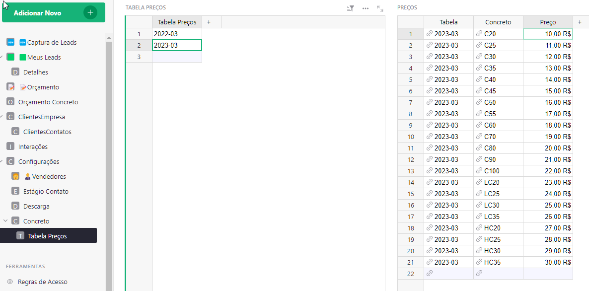

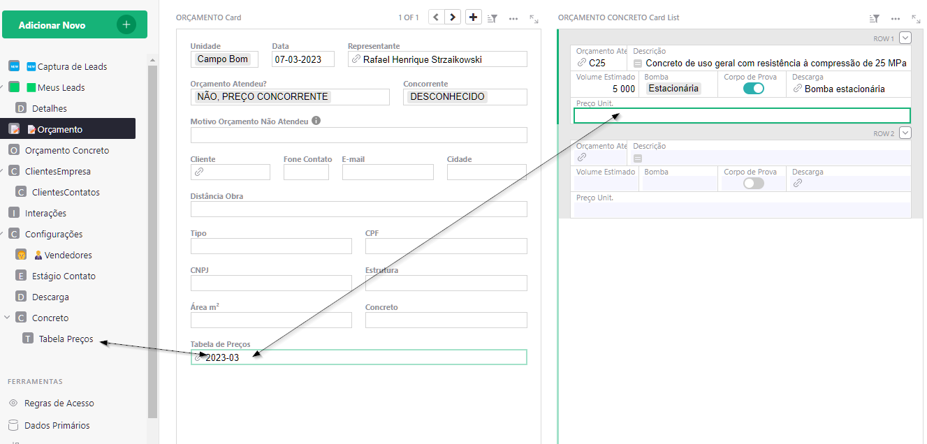

More specifically. Right now, I have a table called BUDGET, which I will use to create budgets for clients.
In each budget, I select a YEAR PRICES TABLE (one for each year). The prices table is connected to a n-n table where I have the period, the item and the price of the item in that period.
So, I also have the ITENSBUDGET table, which references the BUDGET table.
Thus, I select a budget and include several items. The price of the iteam however must be the one from the period selected in the budget.
Here the budget on the left and on the right the itens list.
Here the prices table. So, in the itens list, I selected concrete code C25. And in the budget the Price Table from March 2023. Therefore, price per unit should be R$11 m³ (fictitious price right now)
What is the formula I should use? I will post here what CHATGPT will tell me.
