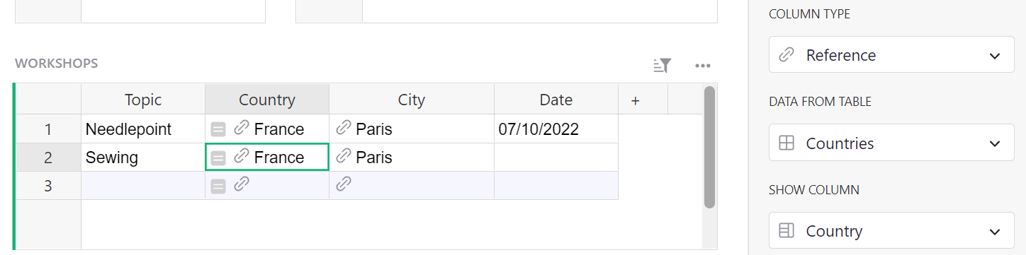

Last, we have our Workshops table. This table contains a Country column and City column - both are reference columns. The Country column points to the Countries table and the City column points to the Cities table. We are going to link this table via the City column so under ‘Select By’, I selected Cities.
Now, this table will update based on what city is selected in the Cities table. The City column in the Workshops table will also auto populate based on the city that is selected in the Cities table.
As you see in the screenshot above, the Country column does not populate. We can do this with a formula.
$City.Country
Here, we are using dot notation and using the reference column City to pull information from the Cities table. Specifically, we want to pull the value from the Country column of the Cities table.
Now, both City and Country auto populate.
Please let me know if you have any other questions.

Instead of the formula returning the country from the Cities table, it is return Cities[2] (assuming Paris is city 2–I am not sure).
How do I get the text value?
The example is very confusing because of similar names: City actually means the City column of the workshops table, which resolves to a reference to the Cities table.
The formula column should also be a reference column. In this example, the Country column of the Workshops table is a reference column that points to the Country column of the Countries table.
Cities[2] is the record ID, meaning the record’s ID in the Cities table is 2. When using reference columns, it’s actually pointing to an entire record in the referenced table. Under ‘Show Column’, we choose the label we want to see to represent the record.

The trick was to make the reference column type AND supply a formula. And it’s more tricky than that:
the reference is to countries, but the value for the formula refers to $City to get the Country Column.
