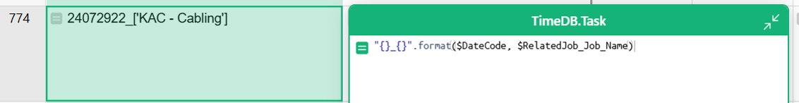

This is just what I was looking for, but my $Ref result displays in [‘Brackets’]. How can I remove them?
I have the same formula on another table that works perfectly. $RelatedJob has a Dropdown Condition, but I removed it temporarily and it didn’t resolve the brackets.
Would have to see the document to be sure, but the brackets likely mean that $RelatedJob_Job_Name is returning a list with a single value. You could try appending [0] to return to first value (i.e. $RelatedJob_Job_Name[0]) but there’s probably a better way to set things up if that column should always have a single value.
That did it! That is a Reference List field, which I may just change to single choice, but the [0] works perfectly! Thank you!!
