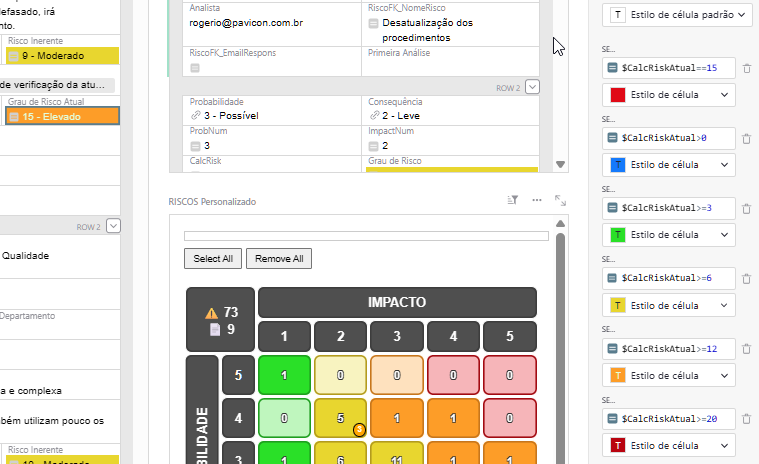

The behavior seems even more erratic than I first realized.
Look at the top left… 15- Elevado in red font with orange background. The red font is the font color for the ==15 condition, while the >=12 has an orange background and dark green font.
BUT THEN I changed the >=12 to a LIGHT green font and now the cell displays ONLY the >=12 formatting

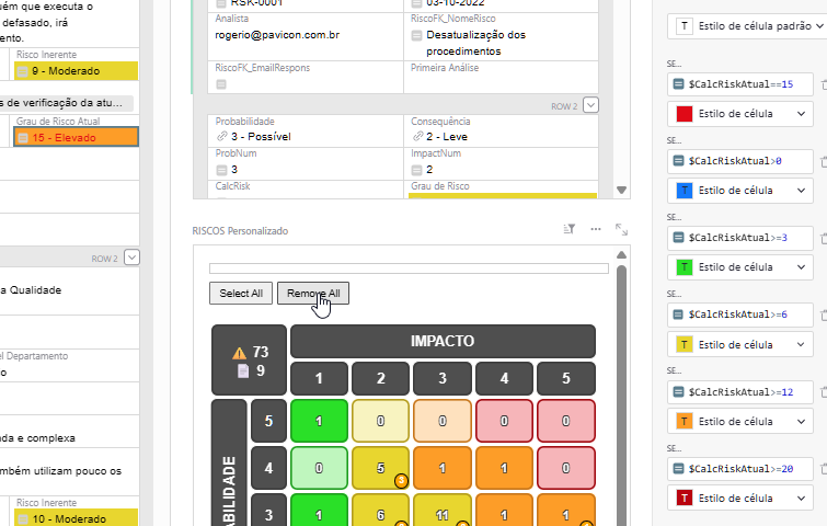

EDIT
OOOOOOH…. I see what is happening. Kinda.
I changed the >=12 to orange background and TRANSPARENT font color (white square with diagonal red line over it). It showed the font of the FIRST true condition. (==15)
Then I changed the >=12 to TRANSPARENT background… since >=6 is also true… and >=12 background was transparent, it showed YELLOW BACKGROUND!!!
