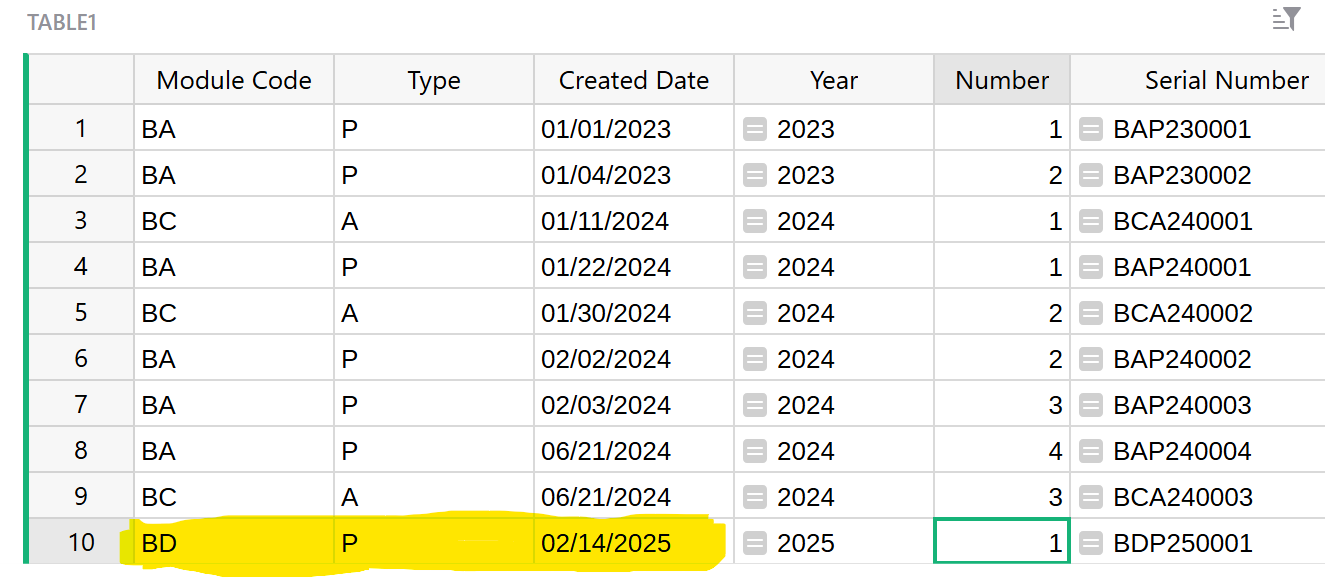

First, I broke out some of the different components into different columns. As you described, I have a column for Module Code, Type and Created Date. I added a formula column to pull the Year value from the date value in Created Date.
Then, I added trigger formula column, Number, to calculate the number to assign to each record (to be used in the last 4 characters of the Serial Number). I made this a trigger formula column because once you assign a serial number, you likely don’t want that number changing. With a trigger formula column, it will only trigger on a specific set of conditions. In this example, it triggers on changes to Module Code, Type or Created Date.
The trigger formula used in the Number column is:
if $Module_Code and $Type and $Created_Date:
  all_group = PEEK(Table1.lookupRecords(Module_Code=$Module_Code, Type=$Type, Year=$Year))
  return PEEK(MAX(all_group.Number))+1
First, the formula checks to see that Module Code, Type and Created Date all contain a value. If so, then the formula uses lookupRecords() to find all records in the table where the Module Code, Type and Year match the values in this record.
Then, it finds the MAX() value in the Number column for those matching records and adds 1.
Finally, I added a formula column for Serial Number that adds all these details together to create our final serial number.
You can hide the Year and Number columns once they are set up. The calculations will run in the background as you add records.

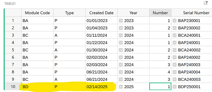

Thank you, this was very helpful, I thought I had it working but my Serial Number is not updating the last number. I imported my Part Number into the spreadsheet so I could check that it is working as it is supposed to:
Here is the code for the Number column:
if $Module_Code and $Type_Single_Letter and $Created_Date:
all_group = PEEK(Table1.lookupRecords(Module_Code=$Module_Code, Type_Single_Letter=$Type_Single_Letter, Year=$Year))
I should state one other thing, and I think I know how to do it, once the number is created I do not want it to increment if any changes are done to the row. I know I should uncheck Apply on Record Changes, do I also want it to uncheck Apply to New Records or is that needed whenever I create a new record it checks for a duplicate and increments it?

Natalie,
When I add another line it is throwing an error, can you tell me why it is not incrementing?

Hi Gary!
I apologize for missing your earlier message with questions!
I updated the formulas in the example document to avoid the errors you were encountering when adding a new row. They take into account null values so you won’t see the #AttributeError.
I’ve also updated the formula in the Number column so it will only calculate if no value exists yet in the cell. If no value exists and the other criteria are met (Module Code, Type and Year are filled in), then the number will be calculated.

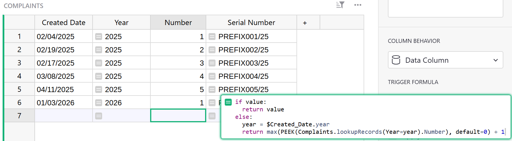

Thanks @natalie-grist, I see now that I was breaking the function by setting the “Module Code” column as a constant using the formula
= "PREFIX"
In truth I am trying to reuse the example to create a serial number in the format “PREFIX001/25”, but PEEK does not work if the value of the “Module Code” or “Type” column are being created by a formula and I also cant get it to work if I am only peeking at the “Year” column.
This is what I am adopting from the example:
if value == None and $Year:
  all_group = PEEK(Complaints.lookupRecords(Year=$Year))
if value:
  return value
if $Created_Date:
  return "PREFIX" + str($Number).zfill(3) + "/" + str($Year)[-2:]
I have shared the document with support@getgrist.com.
Hi @Howard_Shand !
Thanks for sharing your document. It was getting tripped up because both the Year formula and the Number formula were calculating concurrently. In your use case, you are creating a record by selecting a Created Date. Then, all of these formulas are calculating at the same time so the Year calculation isn’t necessarily complete while the Number calculation is happening. We can calculate the Year value inside our Number formula to avoid this issue.
Update your Number formula to the following;
if value:
  return value
else:
  year = $Created_Date.year
  return max(PEEK(Complaints.lookupRecords(Year=year).Number), default=0) + 1
Thanks, that did it.
