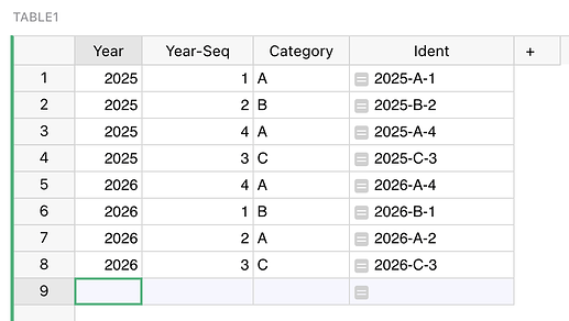

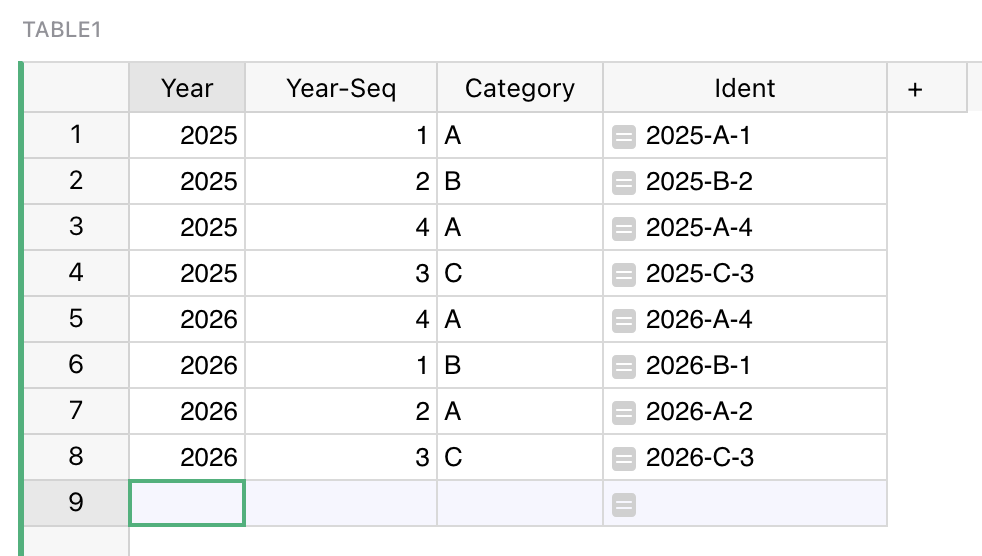

I realized it’s still hard to find a working approach for how to create a column of auto-incrementing numbers using a formula. Here’s a solution that works, for reference, with each new year starting at 1 and auto-incrementing:
In this example, Year-Seq is filled to the next unused number for the current year.
- If you clear the Year, then Year-Seq is cleared too.
- If you change Year, then Year-Seq is reset to the next unused number for the new year.
- Category isn’t used for generating numbers, and only used to show how to create an identifier using multiple fields.
It intentionally shows the numbers out of order to illustrate how the next generated number will be the correct one regardless of the order shown.
