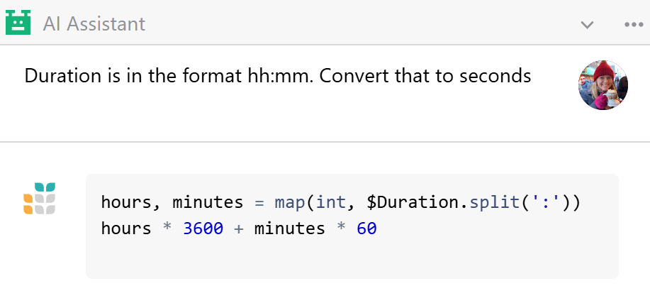

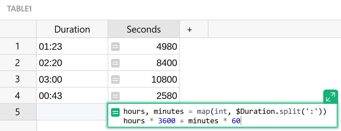

I have a table with durations in the format hh:mm and a formula column that converts this to Seconds. Note that Seconds is a Numeric column.
I used the AI Assistant to generate this formula

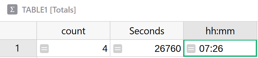

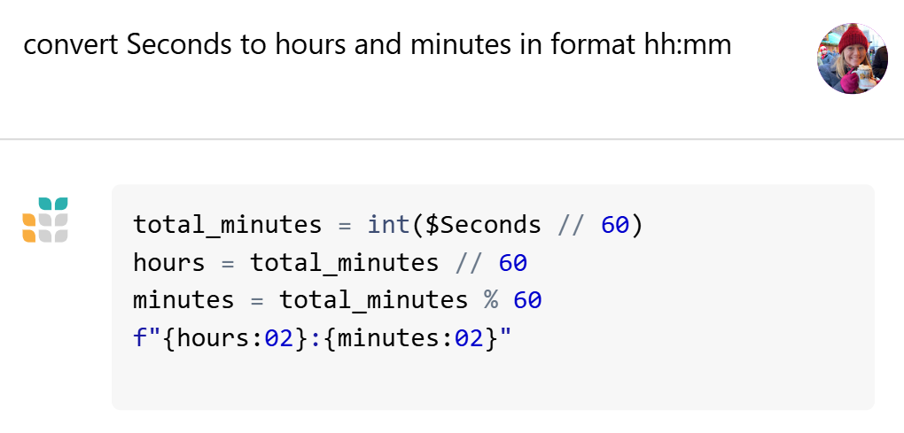

Then, I created a summary table based on the same underlying data. It summarizes the Seconds column. I used the AI Assistant again to convert this back to hh:mm format.
You can hide the Seconds columns from both tables. These are essentially helper columns to calculate the total time and display it in your desired format. These will continue to work behind the scenes when hidden from the view.
