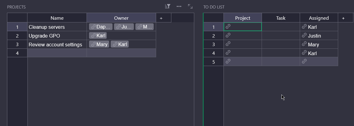

I think you try to compare a single reference (contains only 1 person) with a reference list (could contain 0, 1 or more persons). The proper operation is to check if $Assigned is one of the values in choice.Owner, something you can achieve with :
$Assigned in choice.Owner
Behavior with this formula :

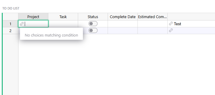

firefox_2DfHjLSHah

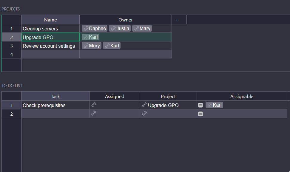

To get further in the structure, a project can have many tasks, while a task is always part of a single project. It is possible to link TO DO LIST with PROJECTS to automatically assign new tasks you create with the currently selected project :
  1. In TO DO LIST view > Table > Data > Select by : PROJECTS
    The “Project (name)” column will now be created automatically with the selected project, so you can get rid of the dropdown condition
  2. Add an “Assignable” column :
    • Type : Reference List
    • Data from : Employees (or your persons table name)
    • Formula : $Project.Owner (you can hide this column after that)
  3. In “Assigned” : set a dropdown condition to choice.id in $Assignable
You should obtain this kind of user experience :
firefox_PzbKmQqWiI
