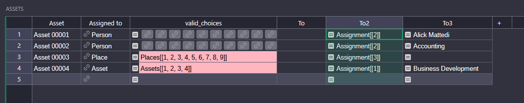

Hello,
first of all, thanks for your time :slight_smile:
Sadly the solution (if I applied it in the right way…) does not work.

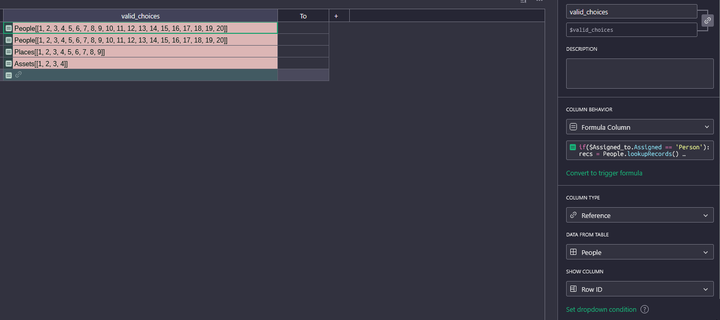

Before continue, I would like to know why the result of the column valid_choices changes in a strange way.
I set valid_choices as Reference List and if Assigned to is Person then it loads all the rows from People table correctly (even if I neither know if that is the expected way data should be shown :sweat_smile: ), but in Place and Asset cases it loads the ids and the cell is red.
Instead this is what happen if I set the column as Reference
And this is what happen if I set as Choice
…or Choice list
When I set Choice or Choice list these are the choices.
And this is what happen in the To column.
firefox_Zhx0kqYJxo

There seems to be a slight misunderstanding here. You see, when you set a column to type ‘reference’ or ‘reference list’, you’re effectively telling Grist that this column will hold references to one specific table. It can’t hold references to multiple tables, such as all of People, Places, and Assets, all at once. This is why, when you set your valid_choices column to be a reflist pointing to the People table, all entries that point to the Places or Assets tables show up in red.
Unfortunately this doesn’t just concern they way things get displayed. It’s also impossible to have any kind of dropdown with options that are sourced from different tables.
