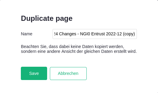

I just ran into the same problem. In my opinion this is potentially a UX regression.
Of course the shallow grey title of the grid widget will provide the title of the underlying data table, but this is not very intuitive.
Eventually “duplicate page” could be called “duplicate view” instead, making it more prominent that the elements to the left are just views?
Nowadays there is also a small warning message, that indicates that no data will be duplicated here.

Maybe together with Duplicate Page we find something as simple as Duplicate Page & Data/Duplicate Page & Content and then it’s immediately clear what the one does and does not do, while the other highlights itself as the “full” duplication?
When wanting to duplicate the underlying data table, it will be cumbersome for regular users to differentiate between the two, source and instance or sometimes even grasp the latter (highly flexible!) concept.
I’m pretty confident that many more people than just the two of us will run and have run into this UX trap :wink: (and eventually lose data along the way, when versioning/snapshotting is not supported, as I did.)
