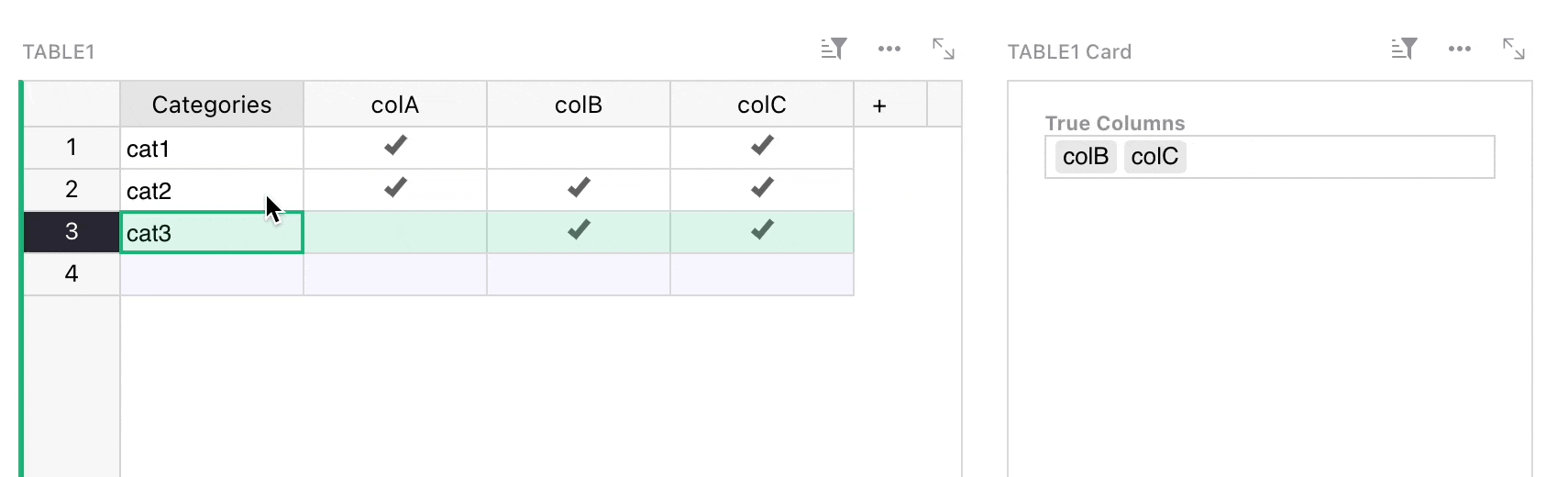

Ah, I see what you’re after now. I can’t think of any way to conditionally/dynamically show/hide columns in a table.
I did make a little experiment to see if there was at least a way to see a filtered view of true columns with trigger formulas. This is a hacky way to do this and there are probably better methods - not sure how it would perform with 200 columns…
column-filter
