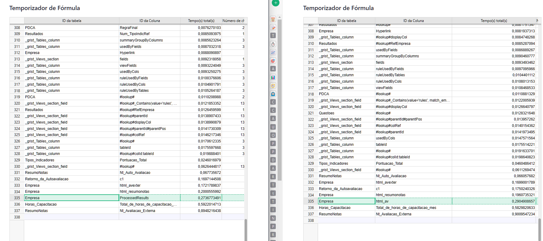

So, now I wanted to test both documents in the Formula TIMER, to see if there was indeed a performance improvement.
the results from the old document… the HTML_av is the formula that I replaced
but the new document…

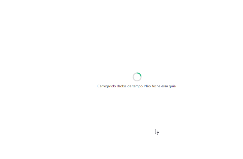

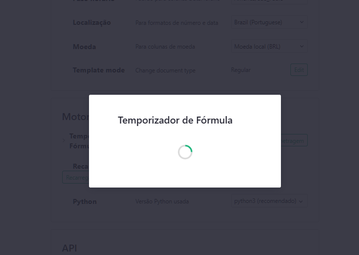

“Loading Time Data. Don´t close this tab.”
and then, back to page 1
OK, RESTARTING THE ENGINE FIXED IT

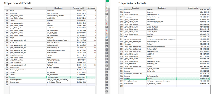

For anyone curious about the results

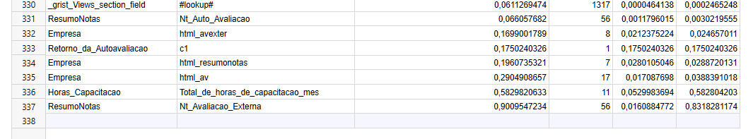

Old Document
Empresa html_av 0,2904908657 17 0,017087698 0,0388391018
New Document
Empresa ProcessedResults 0,2736773491 17 0,0160986676 0,042154789
Not much improvement
Edit 2… avoided any calculation in the Grist formula. Now it just fetches all related data. The calculations are all performed by the widget.
Grist timer for the formula reduced 10 times! From 0.27 seconds to 0.02 seconds!!! YAY!
