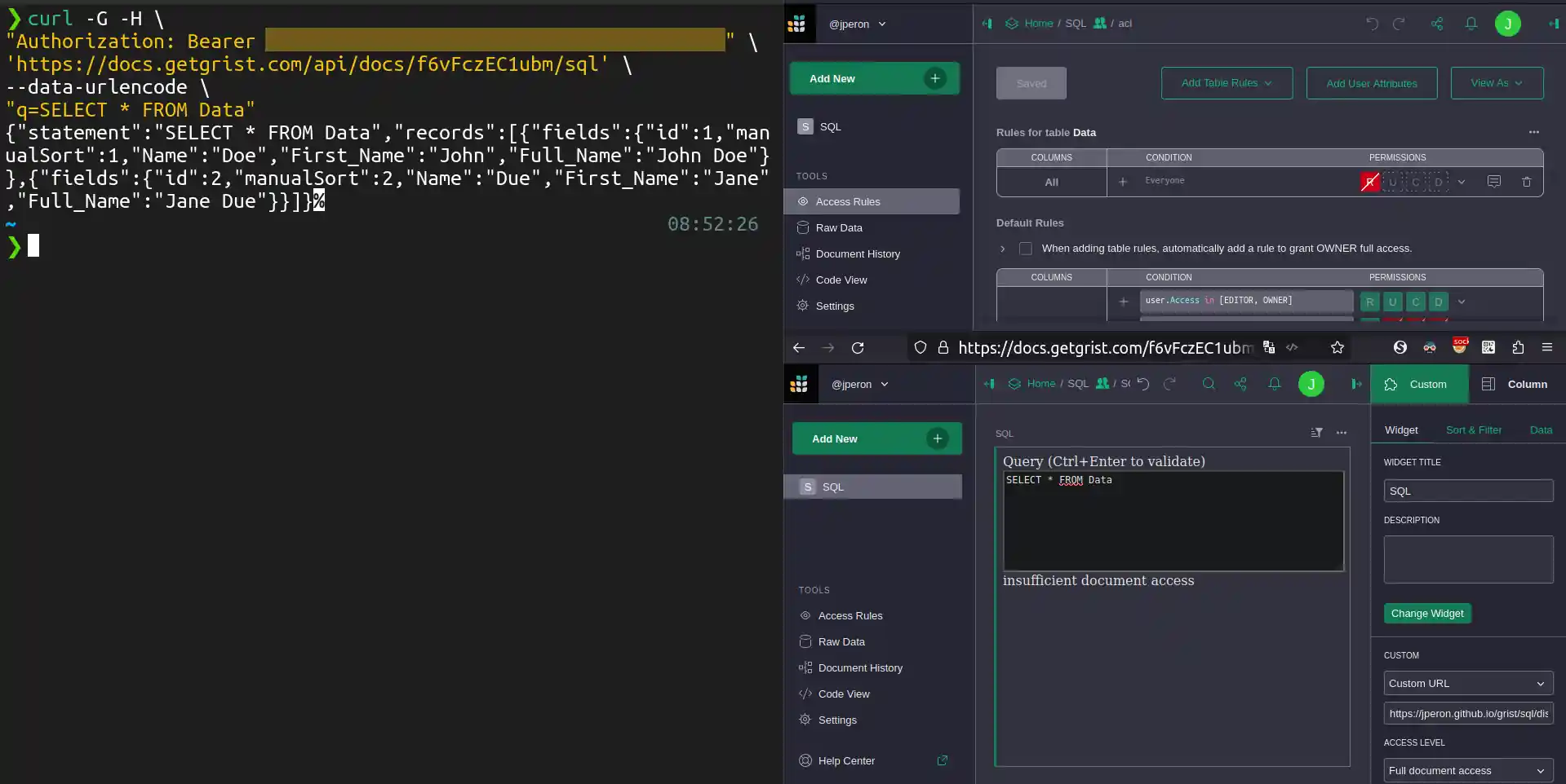

So here is a showcase, with this document: SQL - Grist.
On this screenshot, you may see two browser windows, one with the access rules, another one with a forbidden SQL query (using getAccessToken). On the left, you may see that the curl query using my API Key is working.
I made the document world-editable in case you’d like to experiment.

Thanks for the test case @jperon. I can replicate your results. What I see is that an owner of a document is allowed to use /sql even if the access rules don’t grant full read access to them. This is not totally unreasonable, since an owner has the power to change those rules, but not what I expected from reading the code. I’ll look into it.

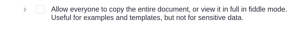

Hi @jperon, is it possible that this special permission is turned on in your doc?

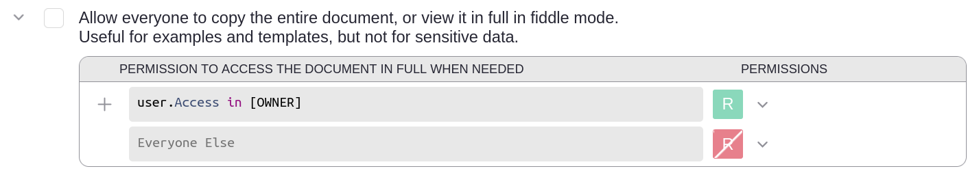

I see that this flag is by default turned on for an owner:
That would explain why an owner can use /sql. But an editor should not be able to if they don’t have full read access or the right to copy in entirety, that worries me.
I think I understand this too now - if a “read only” token is requested, then the access level of any requests made with it is dropped to “Viewer” level. If the “full copies” special permission is what is allowing calls to the REST API to succeed, a viewer (or editor) wouldn’t by default have this permission.
