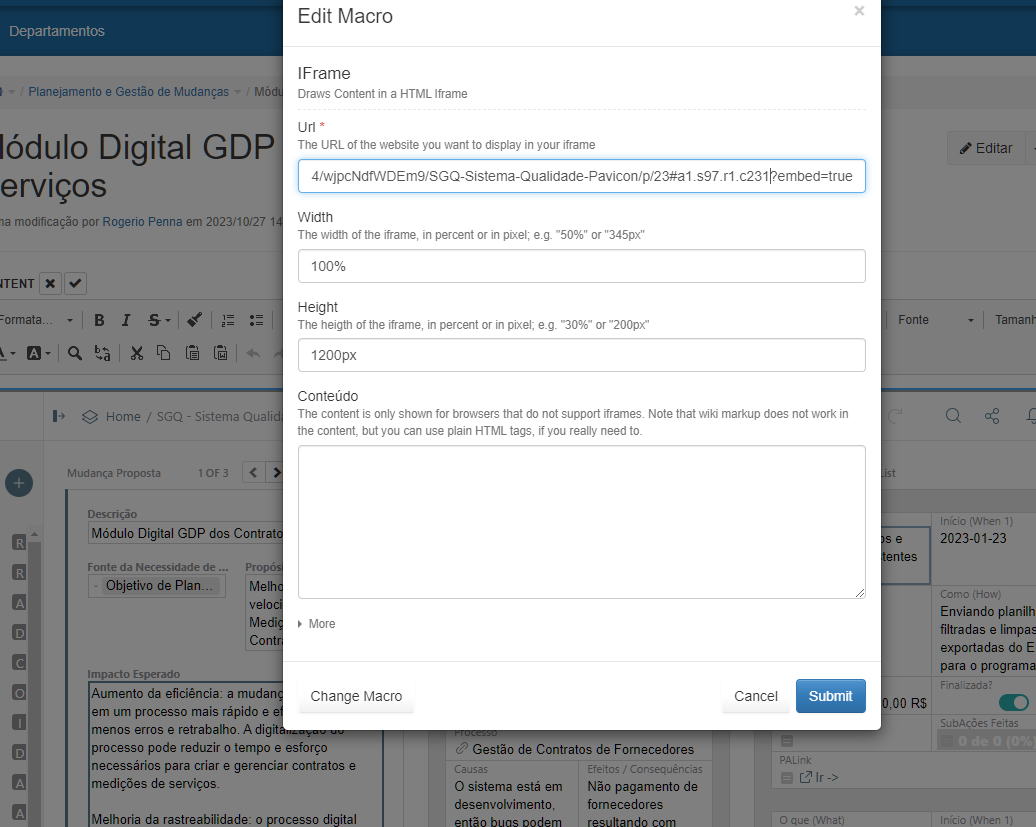

I set embed=true as can be seen in this screenshot
when looking at page code:
{{iframe url=“http://192.168.0.95:8484/wjpcNdfWDEm9/SGQ-Sistema-Qualidade-Pavicon/p/23#a1.s97.r1.c231 ?embed=true” height=“1200px” width=“100%” frameborder=“0”}}{{/iframe}}

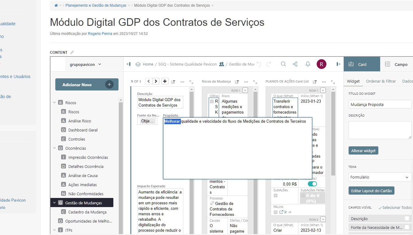

but as you can see here, not only the embeded Grist still shows panels, etc, as I can edit it.

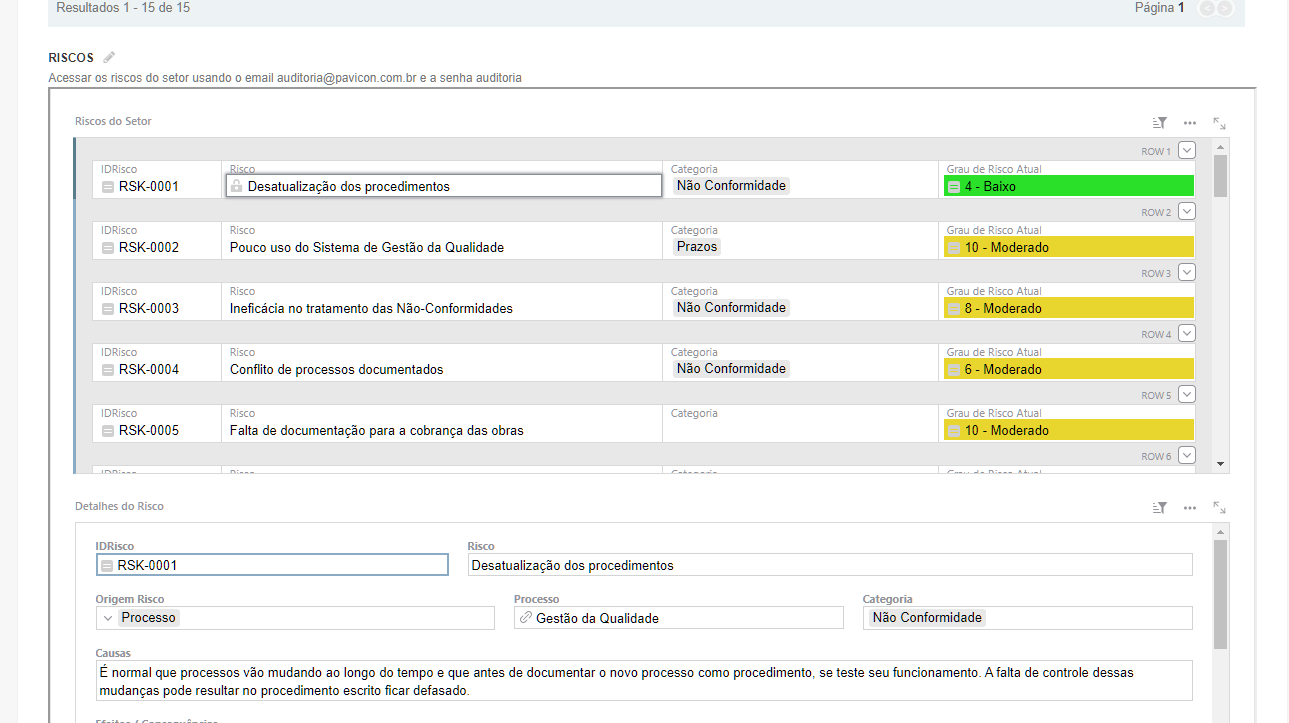

embedding in other areas of the Wiki, it’s working with the ?embed=true
even the locked record symbol appears
the code for the embedding below is
http://192.168.0.95:8484/wjpcNdfWDEm9/SGQ-Sistema-Qualidade-Pavicon/p/33?DepartmentUUID_=65cb068a-9eac-49fe-91e1-a7580d563c46&embed=true
It seems the problem is the self link in that first URL?
Hi @Rogerio_Penna.
Can you try putting the ?embed=true before the #a1.s97.r1.c231?
George
yeah, that was it. So… f***ing simple… Thanks for making me feel an idiot
maybe I missed it on the support page, but you could add (to the computer illiterate like me) info on that on Embedding - Grist Help Center
make it clear that #a1.s97.r1.c231 is not part of the URL and so it should come after the parameters.
