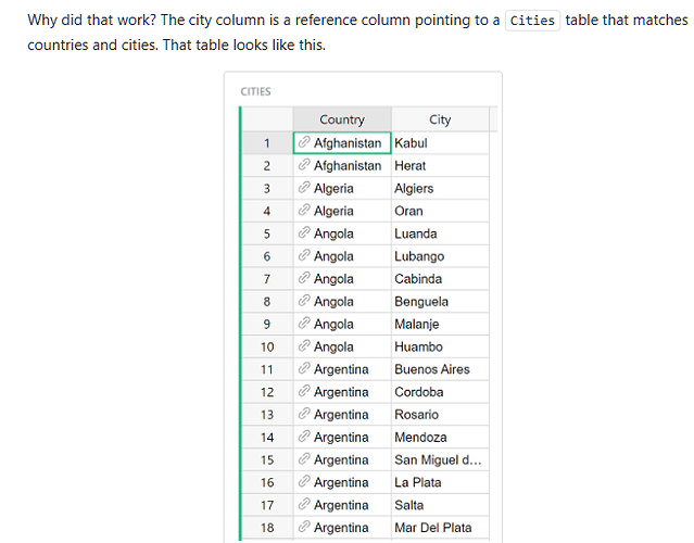

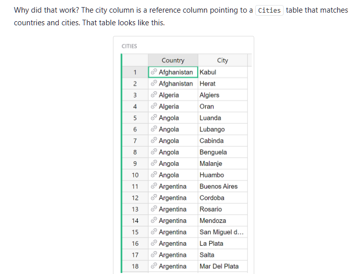

The help article uses as a source, a table where you have one column that is a reference (country) and the second column is simply text

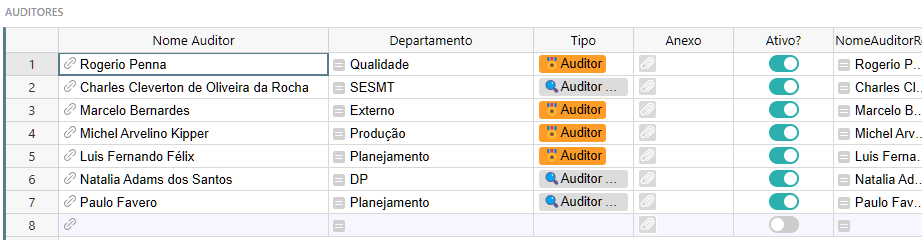

But this is my auditores table
First column is a reference to Users table (Users.name). (where I list several users from the company)
Second column just gets the department that user belongs to, from the departamento column in the users table.

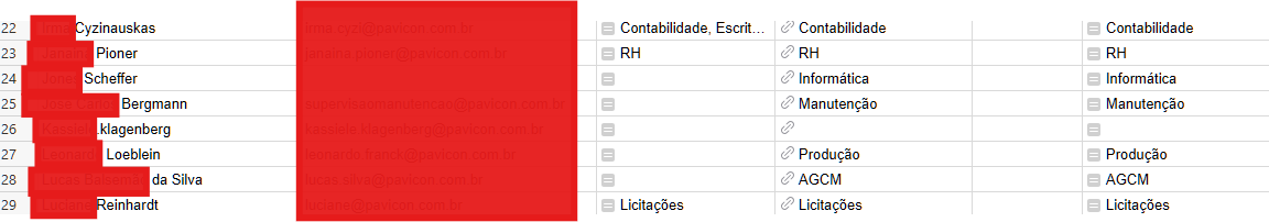

Here is the users table
name and email columns are simple text.
Third column has the formula
Departamentos.lookupRecords(email=$id).Departamento
Where it looks Departamento table to see if that person is the Leader of that department.
The other column is a reference so I can just select departments to each user. Thus it shows department user belongs to, even if he/she is not leader/manager.

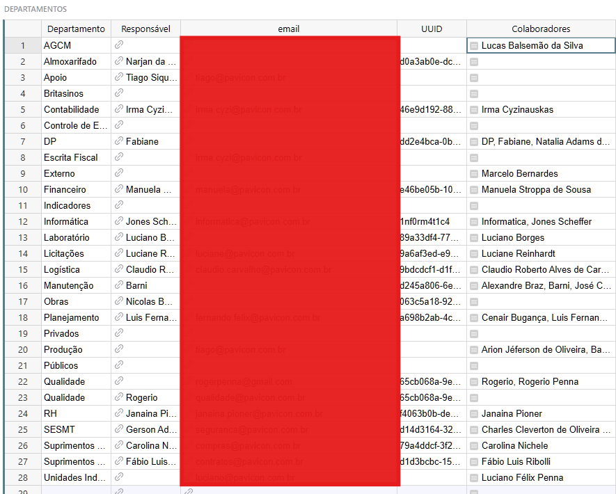

And finally the Departamentos table
Where I list departments, assign a manager (from the users) to it. I also created a field where it lists all users who belong to that department, trying to make my filtered reference dropdown work.
But it didnt work.

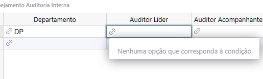

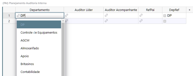

So in the Audit Plan table, I select first the department that will be audited
Notice that not all users are Auditors, so I must select an Auditor from the Auditores table
As you can see, from the auditores table, showing the Auditor name, I check the Departamento column in the Auditores table and compare to the selected Departamento I want to audit.
But the drop down is blank
as I understand, it should show only Natalia when the formula is == or everyone except Natalia when the formula is !=
Btw, notice I also have types of auditors.
Is it possible to filter by TWO fields? As first auditor, I only want to allow Auditors NOT from that department and Leader Auditors.
Yes, you should be able to filter by multiple fields by using and and or (e.g. choice.Departamento == $Departamento and choice.type == "Auditor")
