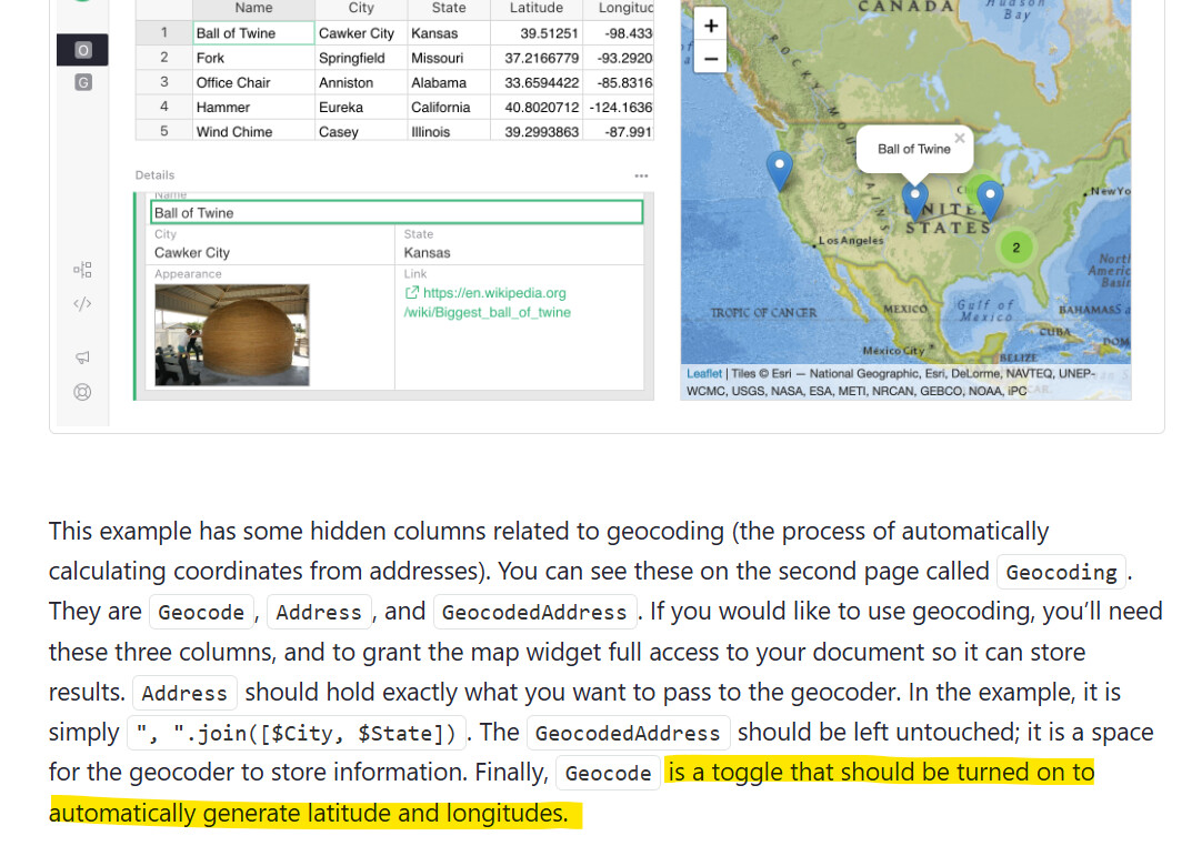

I was looking at the help docs for the map custom widget:
towards the bottom there is this bit:
when i try it out it doesnt seem to work. and i cant tell if its trying anything at all.

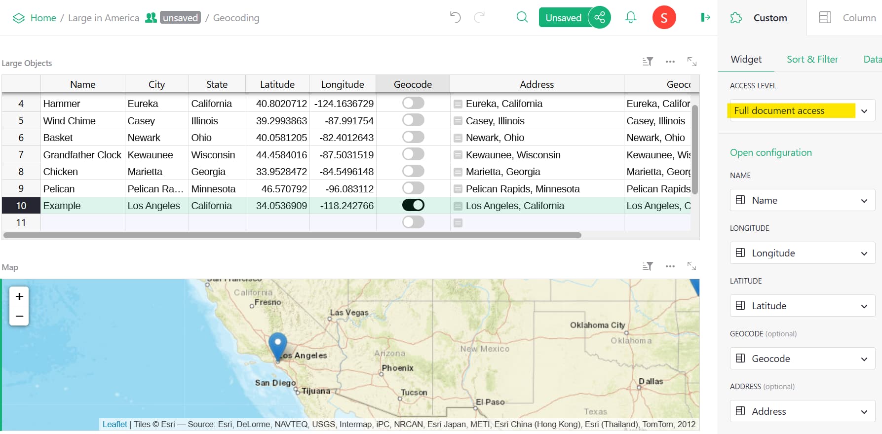

to be clear, i click on the grist map example:
and then I navigate to the Geocoding menu/page, enter a city and state (Los Angeles, California) and click on the toggle. Nothing happens. And i dont see any code behind it either. Also the map widget is not configured correctly either. i just want to know the code behind whatever retrieves the latitude and longitude from a city/state etc…
Hey @Mr-Rooj !
Apologies for the configuration problems! I have updated the example so it should be fixed now.
https://public.getgrist.com/3boQPJrgFmFi/Large-in-America
The map widget has to be configured in order for the geocoding to work. Since it wasn’t configured, it wasn’t geocoding the address you added. Now, when you navigate to the Geocoding page, you’ll notice the map is configured. You can add a City and State and click the toggle and the Lat/Long coordinates will be returned as initially expected.
