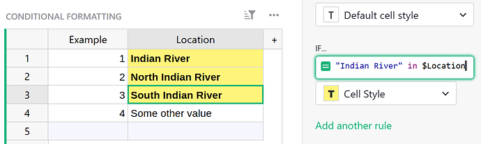

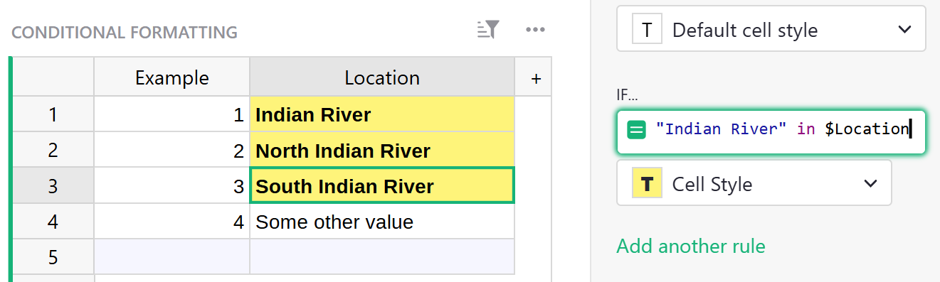

Hello,
Will you suggest a formula for matching a partial string in a column? For example, in $Location, I want to highlight all entries that contain partial string “Indian River”
Thanks!
Hey @Doug_Bomeisler !
You would use the in operator to check if a specific string appears within a cell. Using your example, the conditional formula would be;
"Indian River" in $Location

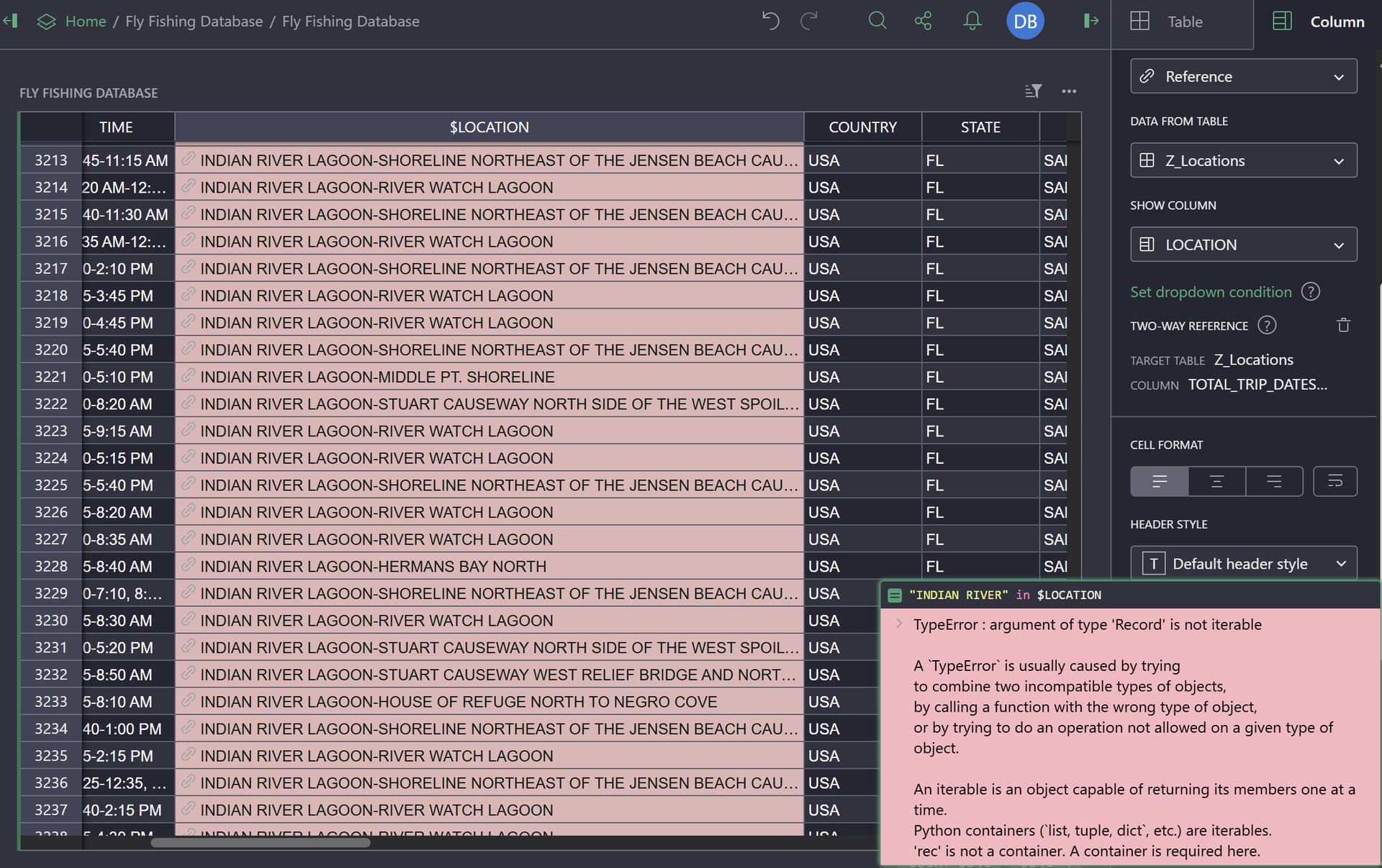

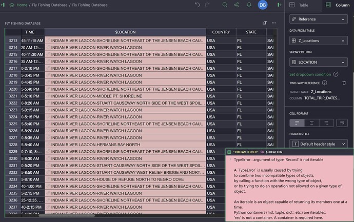

Thank you, Natalie. That is the exact formula that I tried but it did not work. What I failed to mention previously was that $LOCATION is a reference column (a two-way reference column), and this appears to be where the failure lies. Reference columns don’t appear to support conditional style formulas.

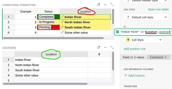

Ah yes - with a reference column, it’s storing a record’s unique ID, not the value you’re actually seeing. You select a value under ‘Show Column’ to use as a label to represent the record. We want to check for a string match in the Location column in the referenced table so our conditional formula needs to be modified to "Indian River" in $Location.Location
This uses dot notation to look at the referenced record in the Location column. Specifically, we want to the know the value from the Location column in the referenced table.
Thank you Natalie! Very well explained, that saved me a lot of time and frustration.
