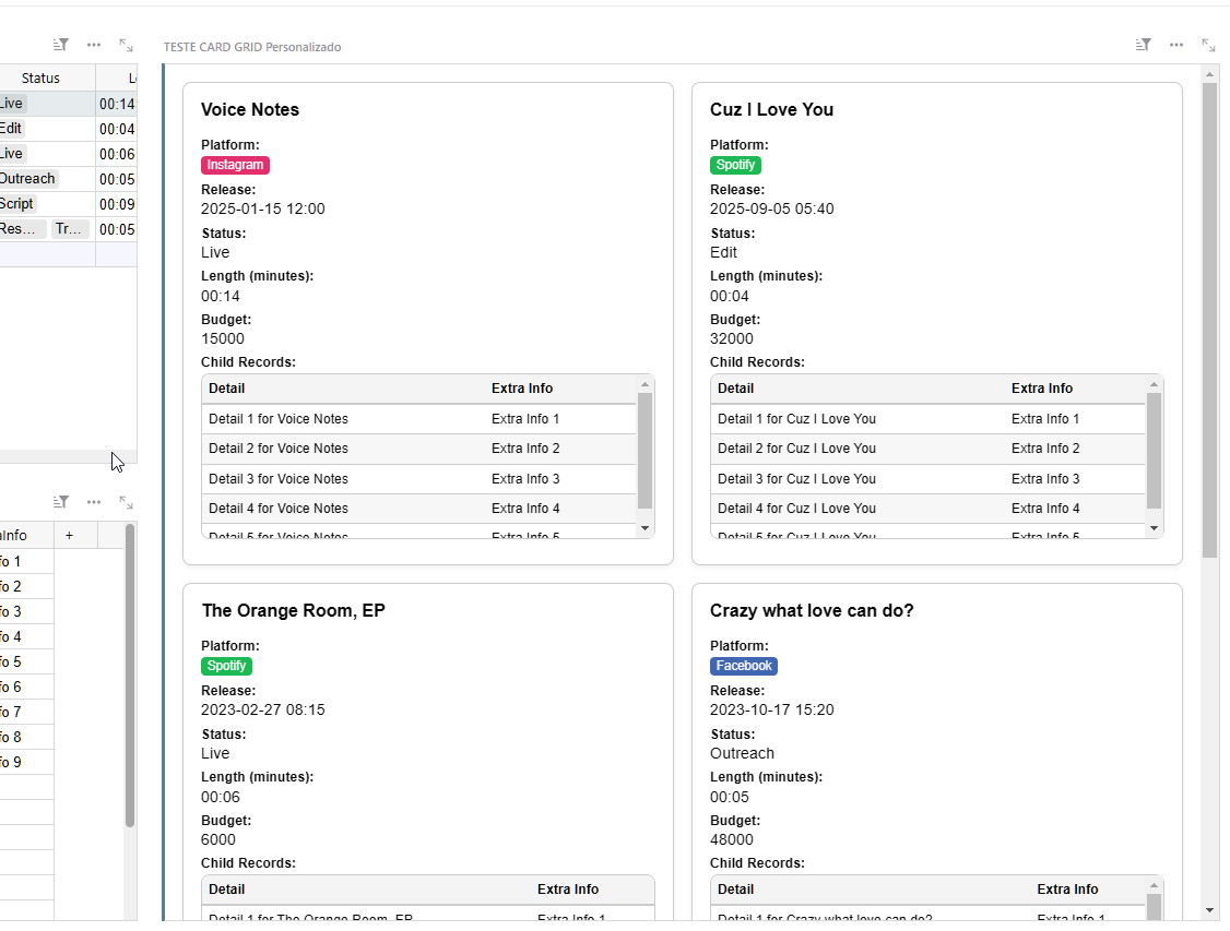

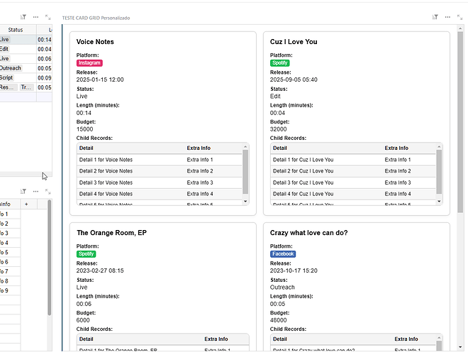

How to access child table and records in Grist Widget Builder Column Mappings?
I have hard coded a Cards Grid widget. I mean hard coded in the sense it works for a specific table with specific child table
It fetches the child records and display them as a second grid inside the card.
Now I am trying to configure the Widget to have column mappings. And I have no clue how to map the Child Table it’s columns. It seems I am only able to access directly from the config panel the columns of the main table.

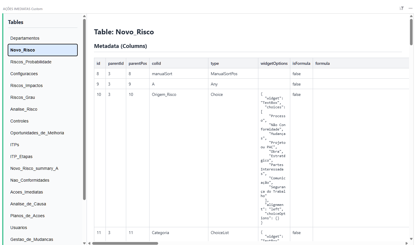

Try this code
<!DOCTYPE html>
<html lang="en">
<head>
    <meta charset="UTF-8">
    <title>Grist Document Explorer</title>

here… another version of the code above but with even more metadata info about each table

how it does look with a real document
Thank you very much, i’m gonna test it and let you know!
