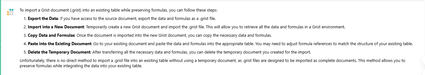

I chatted with Grist’s AI assistant, who explained that there’s no direct method to import a .grist file into an existing table. The suggested workaround involves:
  1. Creating a temporary document and importing the .grist file into it.
  2. Manually copying the formulas and data.
  3. Pasting everything into the relevant table of the existing document.
  4. Deleting the temporary document.
:point_right: This process involves a lot of manual copy-paste, which becomes tedious when dealing with a large number of formulas or complex structures.

Here’s a screenshot of the response from the Grist AI assistant for reference :
