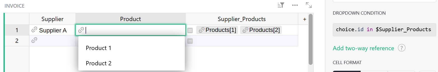

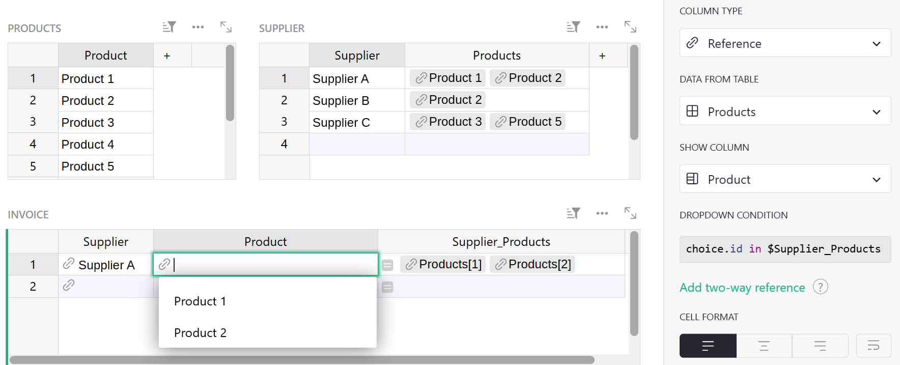

Hey @Rogerio_Penna !

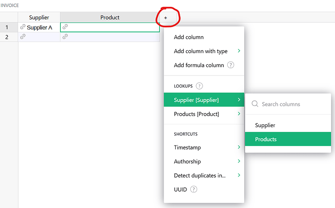

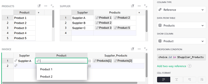

You’ll need a dedicated column in the Invoice table that pulls the list of Products for the selected Client. This could be hidden from view! Conditions are not full formulas so they don’t have reference-lookups unfortunately. Once the column is added, use the condition choice.id in $Supplier_Products and the dropdown should show the correct Products.
Example is set up here: Community #9425 - Grist
Since you already have the Supplier reference column, you can quickly add a new column looking up the Products column from the Supplier table.

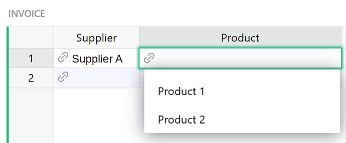

Then add the dropdown condition choice.id in $Supplier_Products to the Product column. This will update the dropdown to only show Products for that Supplier.
Hide the Supplier_Products column from view and you’ll be set!
Thanks!

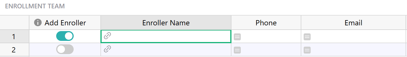

You could probably use an action button to create the record! Another, simpler way is to add a toggle column to the table. It’s only role is to create the record. I’ve done this before for the same scenario where you are creating a record and want the dropdown filtered to the reference (which is filled in automatically with a linked widget). In the screenshot, you can see you just toggle the switch to create the record. Then, the Enroller Name dropdown would be filtered based on hidden columns that are automatically populating based on widget linking.
