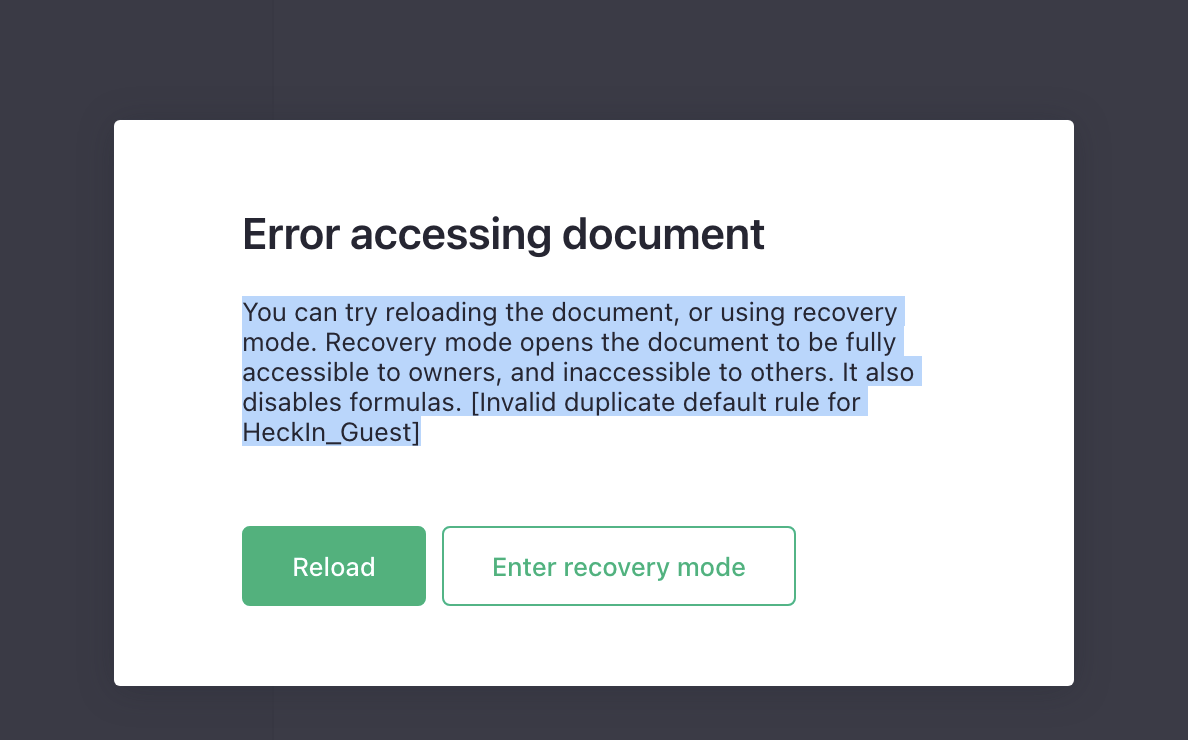

I got error Error accessing document
I got error

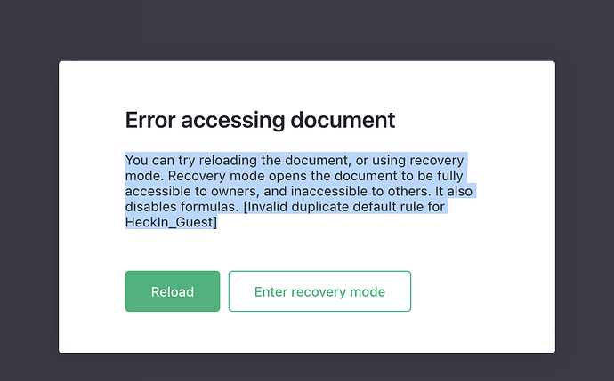

You can try reloading the document or using recovery mode. Recovery mode opens the document to be fully accessible to owners and inaccessible to others. It also disables formulas. [Invalid, duplicate default rule for HeckIn_Guest]
this happens after I change some rule access. now I can’t access my document.
Also, I tried to enter the reload, but it did not work, and I got the same thing.
any way to solve this, I want to get my data document :disappointed_relieved: :disappointed_relieved:
help me plz.

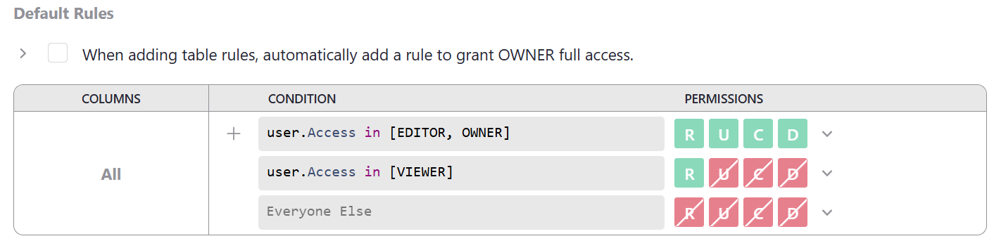

I’m guessing by the error you added a rule to this table under Access Rules:

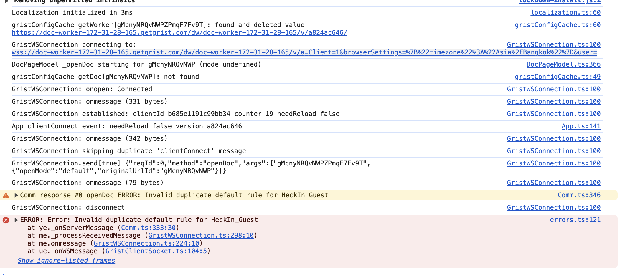

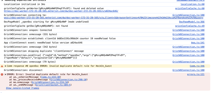

@Nantipat_Tullwattana - thank you so much for your patience as I was out yesterday afternoon and didn’t see you had added support to the document. Our dev team dug into this to see what the issue was (and why ‘Recovery Mode’ wasn’t working). A duplicate access control entry was somehow added to the doc, causing the error. They removed the duplicate and now the document is accessible once again. Our team is looking into how the duplicate was added to ensure it doesn’t happen again in the future.

  1. I try to add a rule on my table then I select some columns and add some conditions (I playground for learning)
  2. I checked Default Rules: When adding a table rule, automatically add the rule to grant OWNER full access
  3. I see a popup warning error about file: buddle (seems like cache)
  4. I refresh the page (Getgrist) for a reason maybe I can fix of struggle caching
  5. I got an Error accessing the document and can’t recover mode (I entered for recovery and not working)
I’m the owner document.
I got Recovery mode by entering but not working (I entered then got the same error like a loop )
