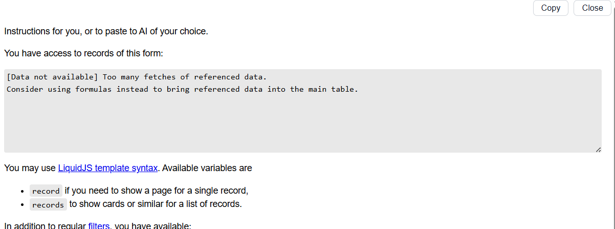

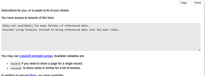

Is it supposed to display this error on the open configuration section?
I’m not sure why it’s showing there, but that error was addressed above:
If the template asks for a referenced record or for all records referenced by a “Reference List”, each is one fetch. If you ask for a referenced record for each record of a reference list, then that’s easily many fetches. In that case, use formulas instead.
Yeah i understand when the error comes up when you actually run the vibe view widget but why would it come up when you try to get the fields and the info of the table?
