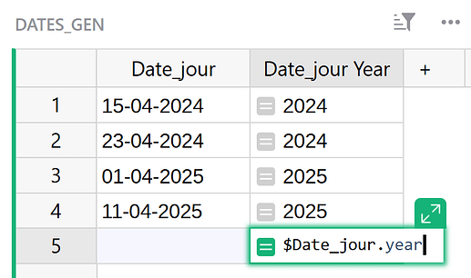

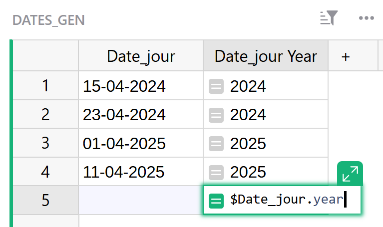

Hey @Guillaume_L !
I would recommend adding a formula column to the Dates_gen table that pulls the year value for the value in the Date column. You can do this using the formula $Date_jour.year.

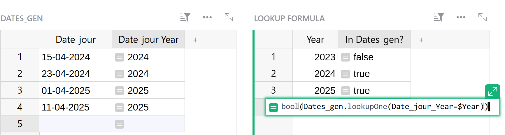

If all you need to know is that a record exists for a given year, you can use a lookupOne formula which is much more efficient than lookupRecords. Once it finds a single record that matches the given criteria, it stops. The formula in the screenshot below uses lookupOne to find a record where the year matches. Then, uses bool() to return either true or false. If it finds a single match, it returns true. If no match is found, it returns false.
Let me know if you have any follow up questions!
Hello Natalie,
Thanks for your reply. I was kind of hoping to avoid adding another column but I guess I have no choice and I’ll go with that
