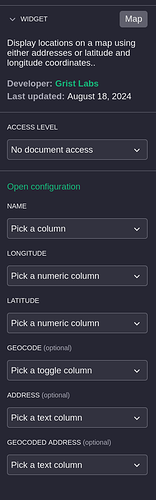

Could you do me a favor @hbernard and double check the mapping? In your custom widget, near the top right, there should be a “…” button. Click it and select “Widget options”. Then over on the right you should see a section like this:
Can you double check to see if GoogMap is mentioned anywhere here?

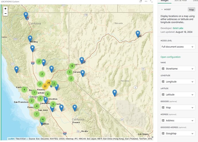

Yes - thank you! It looks like I did include it in the mappings.
Ok, for “Geocoded Address” just put a column that it is fine for the widget to use as a scratch pad to store something in. To avoid sending too many requests to the geocoding service, it keeps track of the last address sent to be geocoded. You can hide the column.
I’ve done as you suggested, and there is no longer any change to my Google Maps column. Yay!
