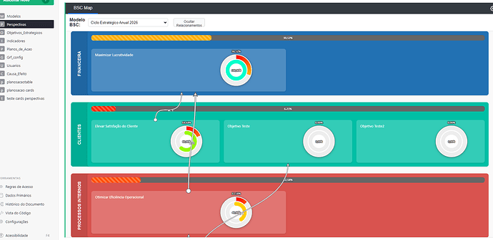

at my company, we have a local Grist on docker. I create a server at pythin serving a directory with the code.
at home, I do the same, but use Grist Desktop
when all is fine and dandy, I send to github.
Was able to develop some pretty neat stuff that way

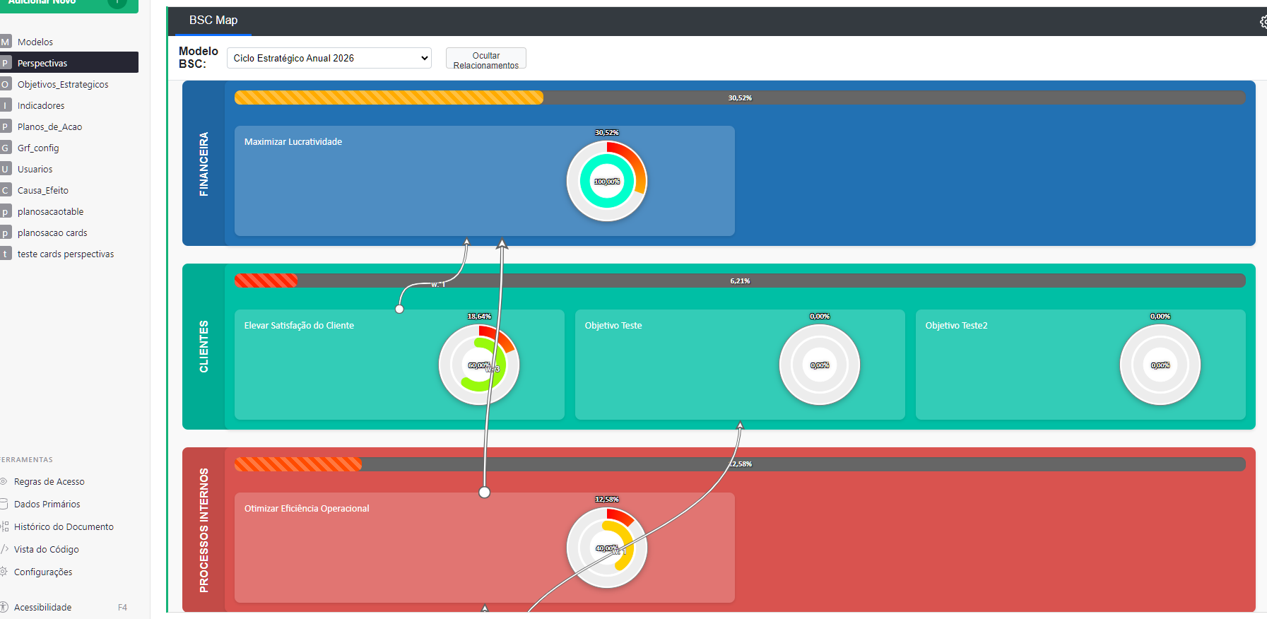

like this SWOT

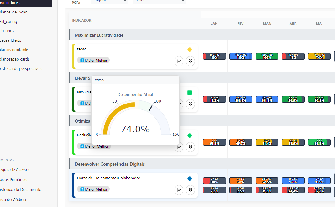

and this indicators panel
