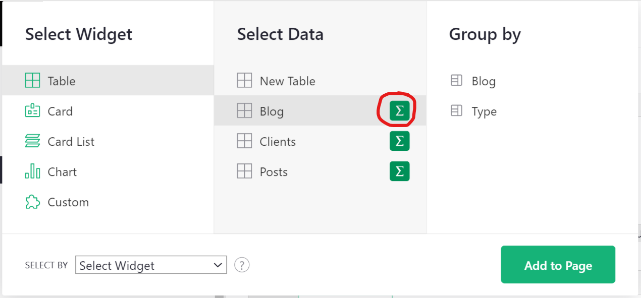

You can add another summary table that will summarize all posts. To do this, click the green ‘Add New’ button and ‘Add Widget to Page’. Click the green summation icon to the right of the Blog data set then ‘Add to page’.
This will add a BLOG [Totals] table that summarizes the entire Blog table. Here we see their are 4 posts.
