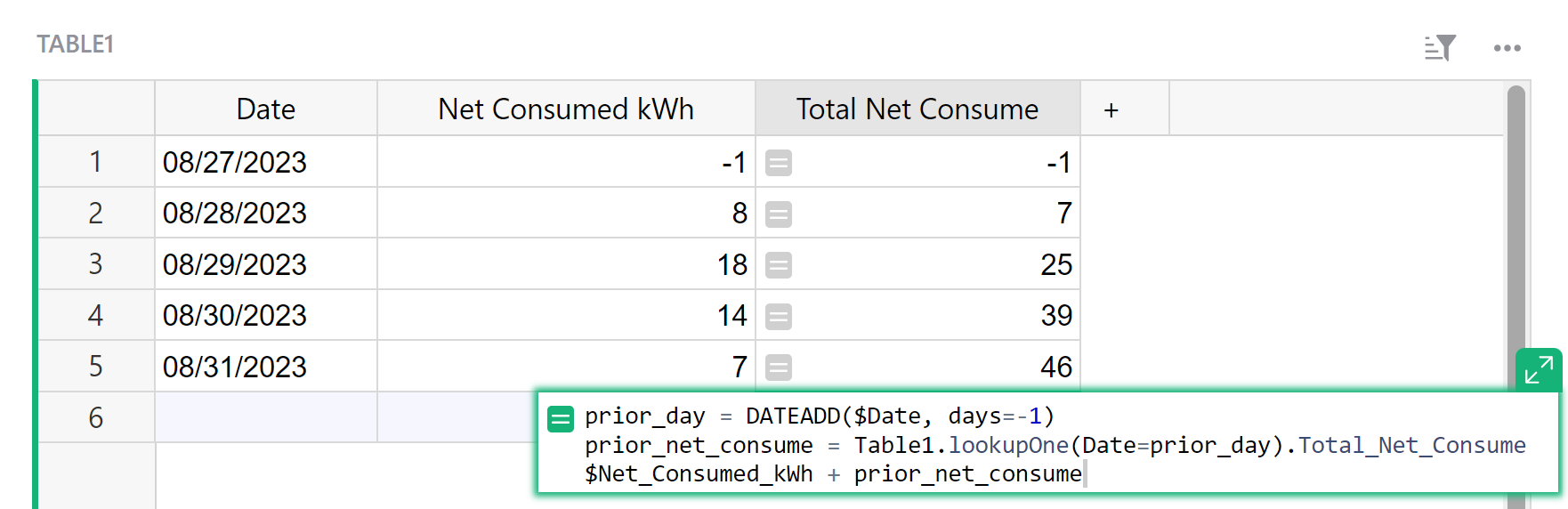

I created a small example here: #4620 - Grist
In the Total Net Consume column, we have the following formula;
prior_day = DATEADD($Date, days=-1)
prior_net_consume = Table1.lookupOne(Date=prior_day).Total_Net_Consume
$Net_Consumed_kWh + prior_net_consume
First, we need to find what the prior date was (so we can find it’s Total Net Consume). To do this, we use the DATEADD() function. Our start_date is the value in the Date column for this row and all we need to do is subtract a single day. We assign this date to our variable, prior_day.
Next, we need to find the Total Net Consume for the prior_day. To do this, we use lookupOne() to find the first record in Table1 where the value in the Date column is equivalent to the date assigned to the variable prior_day. Then, we use dot notation to specifically pull the value from the Total Net Consume column for the record found. We assign this value to the variable prior_net_consume.
Finally, we add the Net Consumed kWh value to the value we assigned to prior_net_consume to get our current day’s Total Net Consume.
