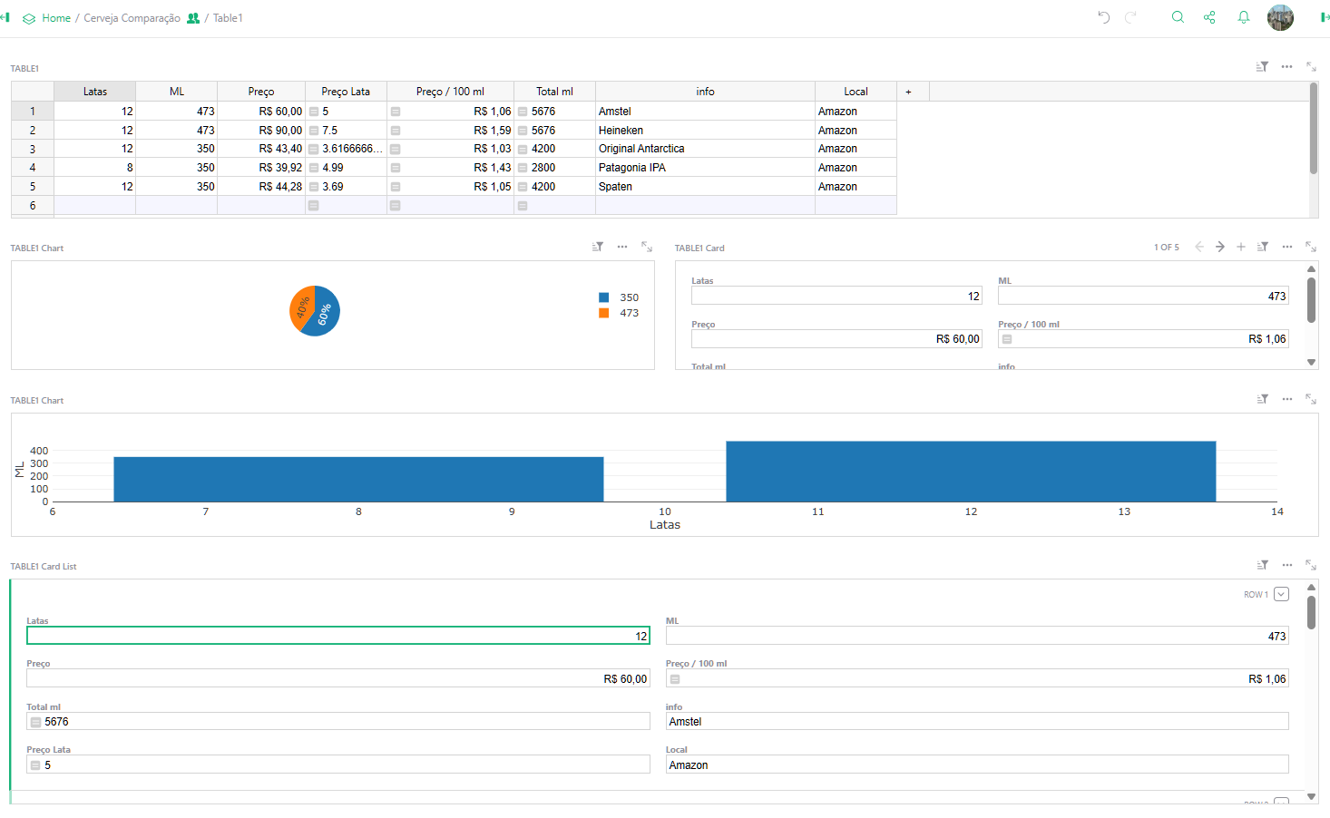

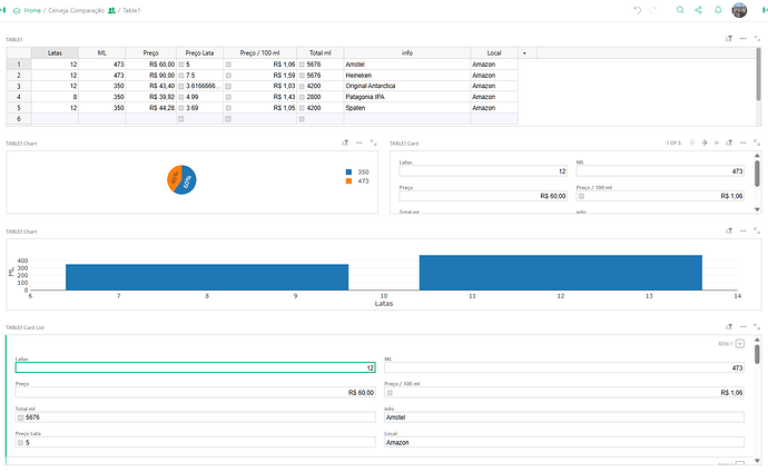

In this new example, I filled a single page with 7 rows of charts. Basically, as you can see, you can´t see anything at all

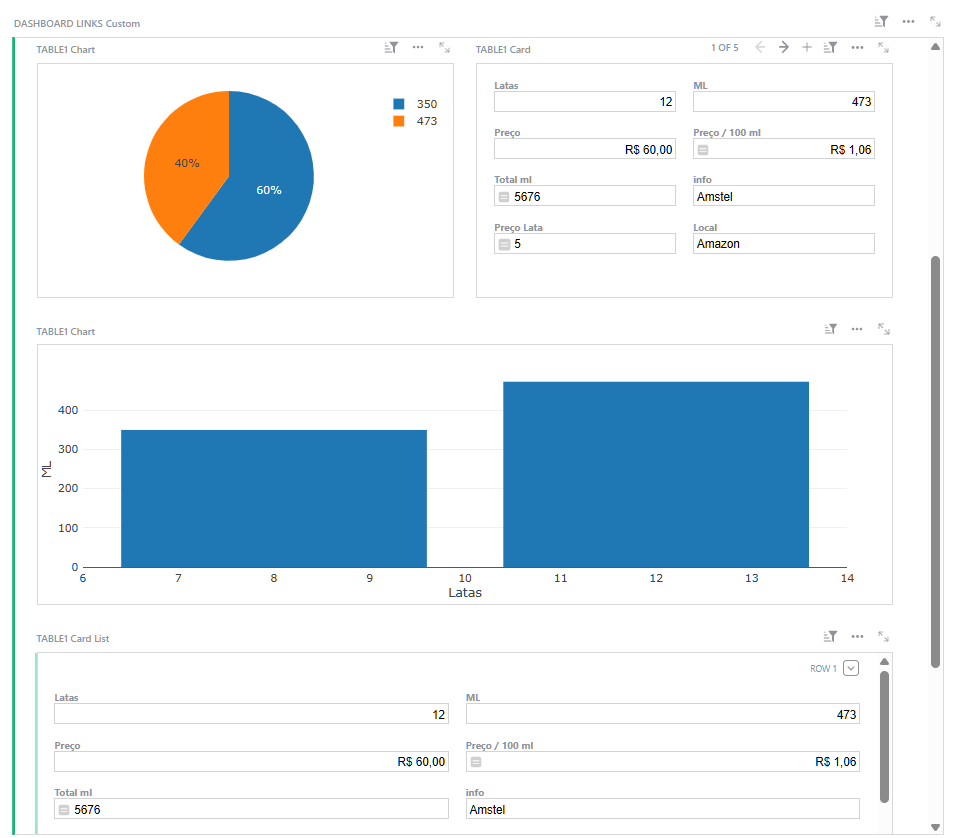

that SAME PAGE above, without changing ANYTHING, seen in an HTML widget showing an iframe link to that page with height set to 300 vh

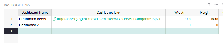

In theory, you can create a table of dashboards. Each row being an iframe link to a different page. Also, you can have two columns to regulate width and height of the iframe link (remember, the iframe link is assembled through a formula with concatenate, etc)

you will need to connect it to a dashboards table, with dashboard name, link of the page you want to show, width and height in pixels.

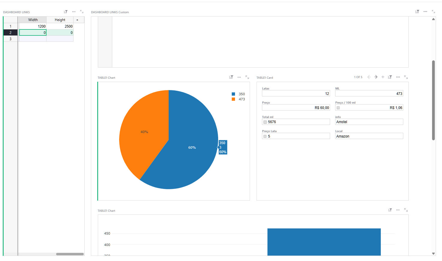

now, even if you have a page with crammed widgets like this below
the widget will display that page with the size you set in the width and height columns, meaning you will have a scroll bar to see the page and the widgets will be larger
width 1200, height 2500
