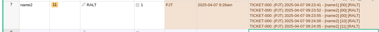

For now I use the following formula which is triggered upon modification of the Last Modified automatic column. It joins multiple columns content in one single log.
import datetime
log=" ".join(f'[{w}]' for w in [$A, $B, $C])
ticket=Change_Identification.lookupOne(User=user.Name).Change_Identifier
current_time = NOW().strftime("%Y-%m-%d %H:%M:%S")
new_entry = f"{ticket}: ({user.Name}) {current_time} - {log}"
return (value + "\n" + new_entry) if value else new_entry
It looks like this but you can adapt as you like:
You’ll see I use a Change_Identification table to justify changes through a change ticket. My dream would be to make it mandatory before allowing any change with an auto-delete of the ticket identifier upon user logout…
However, for change tracking I think a better alternative would be to use the grist internal history but this is not possible for now.
