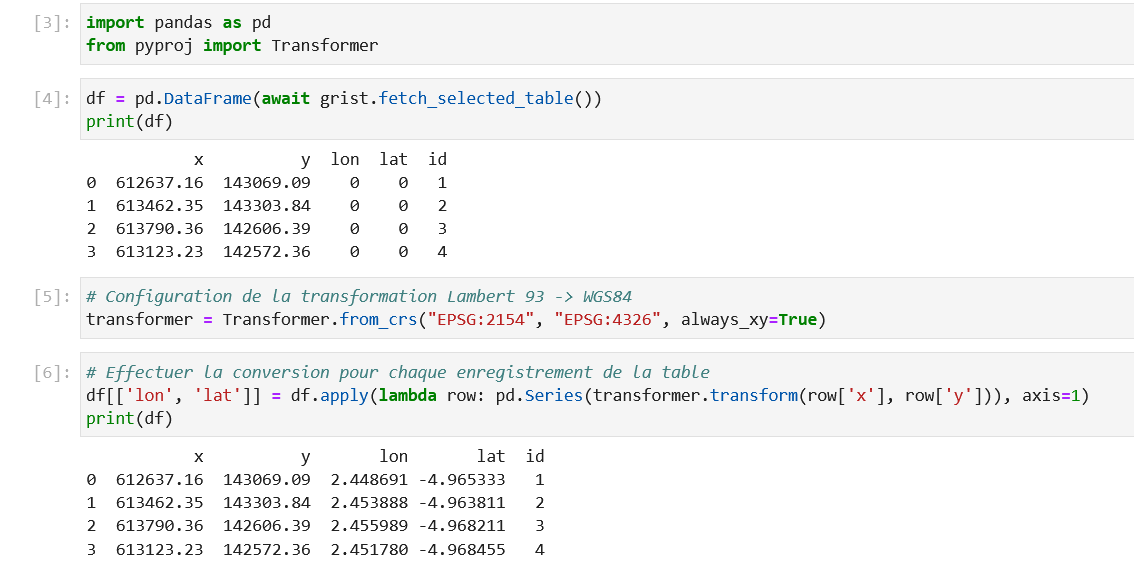

I’ve got a table “DATA” with geographical data that i need to convert from (x,y) to (lon, lat).
I used a python script within the Jupyter Widget.
# Initialisation
%pip install pyproj
import pandas as pd
from pyproj import Transformer
# Collecting data froma table
df = pd.DataFrame(await grist.fetch_selected_table())
print(df)
# Configuration transformation Lambert 93 -> WGS84
transformer = Transformer.from_crs("EPSG:2154", "EPSG:4326", always_xy=True)
# Transformation and append
df[['lon', 'lat']] = df.apply(lambda row: pd.Series(transformer.transform(row['x'], row['y'])), axis=1)
print(df)

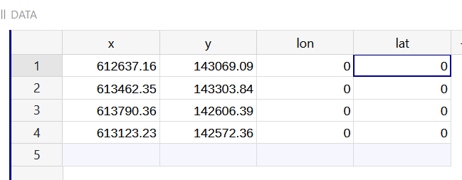

I’ve got no problem to extract and transform my data in a dataframe (pandas)
My problem now is to push this new data in my original table.

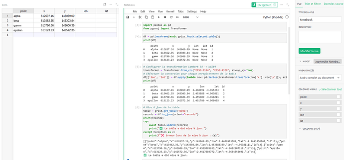

My last test to update my table
# Update table
table = grist.get_table("Data")
records = df.to_json(orient="records")
print(records)
try:
    await table.update(records)
    print("✅ La table a été mise à jour.")
except Exception as e:
    print(f"❌ Erreur lors de la mise à jour : {e}")
But no way to get my update even if i’ve got a :white_check_mark:

Nobody to explain me why i can’t update my table from Jupyter Lab ?!
I tried
records = df.to_dict(orient=‘index’)
or to use an endpoint API POST
response = requests.post(api_url, json=update, headers={“Authorization”: f"Bearer {api_key}"})
but there’s no way to import "requests’ librairy…
That’s strange !
