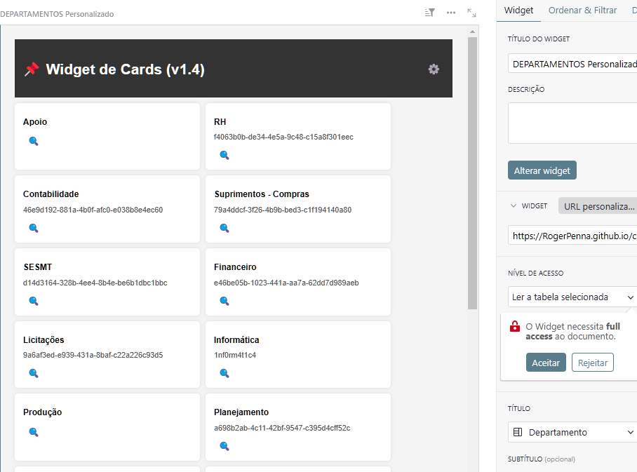

So I started putting version numbers at the top. And noticed that SOMETIMES, they really don´t update. Not with reload. Not with reload+F5. Not by changing the widget permissions. Etc
Even weirder… look at this
I changed the permissions to only table or none. It shows version 1.4 and I get a warning the widget needs full access
and when I click to ACCEPT… it RETURNS to 1.3!! (now after half an hour, it finally stays at 1.4 after clicking to accept full permissions)

It sounds like there might be some sort of browser-level caching happening. A trick you can do is add ?v=123 to the end of the widget URL to fool the browser into not using the cache. Does it work correctly when you do that?
GitHub Pages does have a delay from when you commit your changes until you see them live, and pages may be cached for up to 10 minutes. The trick above can get you around the cache, but there may still be other delays.
