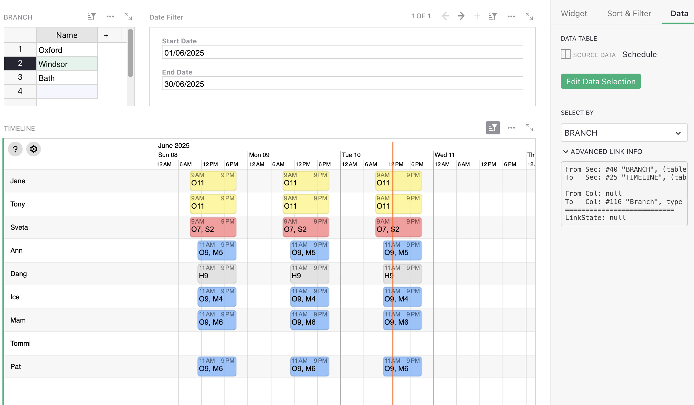

Separately, I am trying to filter the data within timeline by conditioning data selection on the other row selected in a different widget, on the top left: BRANCH), but it doesn’t seem to work at all. The link filter state is null. However, if I apply the same logic to other other widget, it does show the filtered data (on another page). I am not sure if the problem is with the timeline, or with the way I set up the link filter. But I am doing it exactly the same as on the other page, and it does filter there, but not on this page where I use timeline… Any ideas?
Hi @akuz ! The timezone used is the one defined in the parameters of the document (bottom left column).
Filtering data as you do should works… But it doesn’t. I don’t know why and I need to work on it. You can consider this a bug, sorry !

I hope the filtering works soon… I need it to complete functionality of what I am doing this for… Then it would be 100% perfect!
It seems to be a limitation of the way the link between views works. I’ve started a new thread on the subject here: setSelectedRows and cylic linking
I can’t think of a solution at the moment…

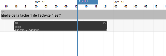

Super boulot,
par contre, je n’arrive pas a faire afficher correctement 2 lignes ? Le rectangle ne s’agrandi pas et la 2eme ligne est tron
quée.
Bonjour,
Avez-vous essayé Alt + Molette ou Alt + 2 doigts (trackpad) - dans la colonne de gauche ?
Dans tous les cas, n’hésitez pas à consulter l’aide pour tous les raccourcis (? en haut à gauche)

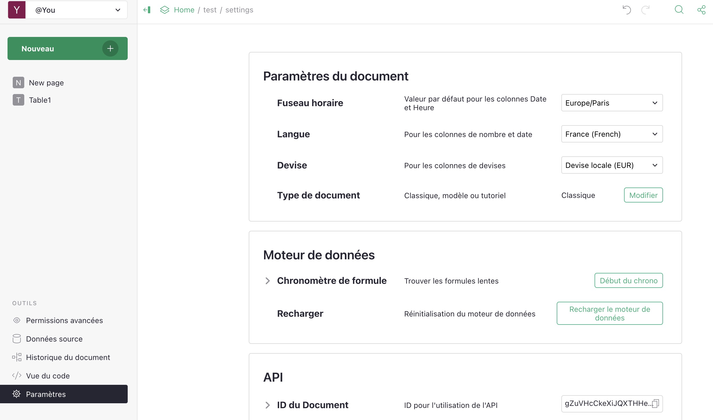

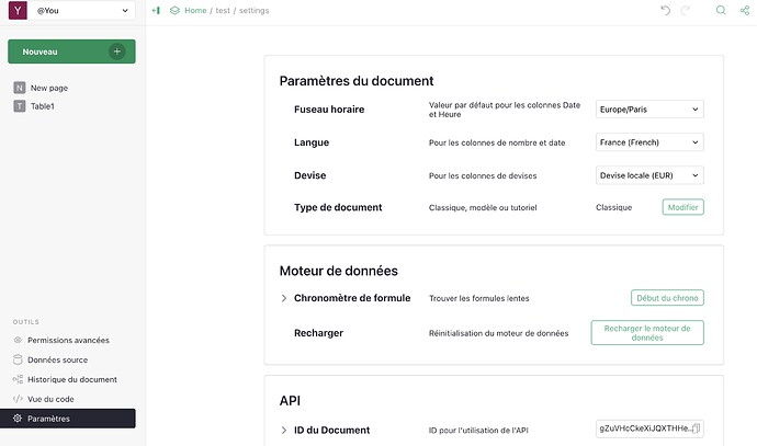

Bonjour Alain,
La langue du widget est normalement celle configurée dans les paramètre du document. (cf capture).
Merci @Raphael_Guenot,
Aussi simple que ça. Ce n’est que du bonheur :tada:

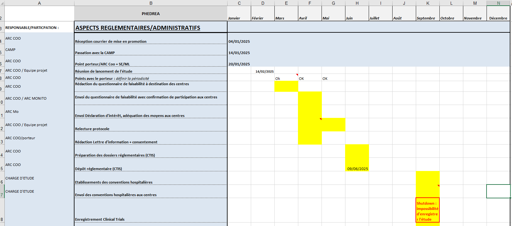

The thing is, I don’t care about the time at all. So your Example doesn’t help me since the Gantt view is still by hour instead of juste date.
But it’s not the only problem I have with the widget. It’s a good start, but as others have stated, it’s not a real Gantt with dependencies etc. I want to have something of this nature :
