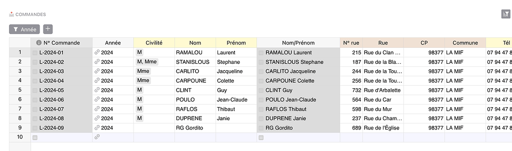

3/ Order management page to view the orders received through the form.
