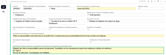

I am working on a register where users mainly interact with a Card widget with dependent dropdowns and role-based visibility (RegOld and RegNew tables).
My challenge:
  • By default, the Card always opens on the first record (Row ID = 1).
  • I would like it to open directly on the last record (highest Row ID or latest Prob_ID) while still keeping the navigation arrows (← →) active.

==> What I am looking for is: a Card that opens by default on the last record while still allowing navigation with arrows.
Thanks in advance! :wink:
NB : One additional complexity in our setup: the register is bilingual (FR/NL) with dependent dropdowns.
I almost solved this part, but still couldn’t manage to lock each row in the language it was originally encoded in.
This makes the ‘open on last record + keep arrows’ request even more important for me, because the Card is the only user-friendly entry point in such a setup.
